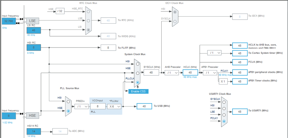

STM32F070RB USB MSC on internal Flash can not format
Hello,everybody Nice to meet you,My trouble is "STM32F070RB USB MSC on internal Flash can not format " ..I have try some idea in community but did not help,so I decided to ask for help,Here are my code on usbd_storage_if.c.
Thank you so much !

 my CubeMX configuration

March 18, 2019
Your write code must manage the block erase and write functionality. If the erase block size is greater than the transfer, or spans, you must manage the data replacement too. You must erase memory before you can write to it. The PC expects to be able to read/write any block and get back exactly what it wrote. If this fails your system will fail.
Test your block read/write functionality outside of the MSC construct first. Instrument your code so you understand the interactions in real-time, your not going to be able to break point or single step an USB MSC.

Thank you �?:)
I understand,It means I have to Manage my Flash ‘s erase and write. So I might be want to make a data structures and algorithms to help me manage my Flash, because F070RB doesn't have sector erase, and I don't want to waste 2kb memory of SRAM for USB MSC.

EVERY block erase two pages works for me
