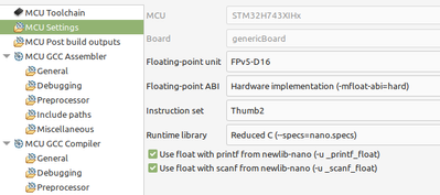

AScha.3
April 17, 2024
I would set in debug a breakpoint at the sprintf line , to look , what is the float now ; + whats in the string, after sprintf ; then run ..and look.
what did you set : in project settings ->
GreenGuy
GreenGuyAuthor
Senior III
April 17, 2024

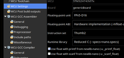

I guess I could uncheck the scanf option since it is not used.  But that does not make a difference.
I already did the break point on the sprintf line.  The float values are good and the string after the sprintf has the garbage characters in it.  I also tried stepping into the sprintf function but it simply steps over it.  The local string buffer is initialized to all 0 upon entering the routine containing the sprintf.
