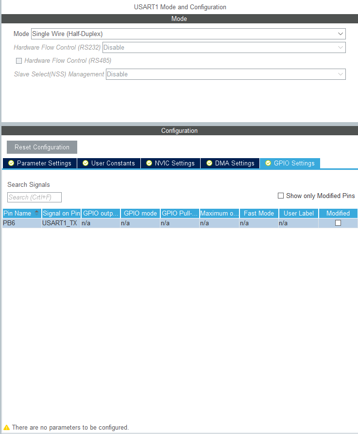

Code Generation Bug in STM32CubeMX ? Unable to generate UART (one wire half-duplex mode) pin configuration, resulting in the inability to use UART.
‎2019-11-04 10:49 PM
MUC: STM32G031G8Ux
STM32CubeMX version: 5.4.0
Package version: STM32Cube FW_G0 V1.3.0
Keil version: v5.28

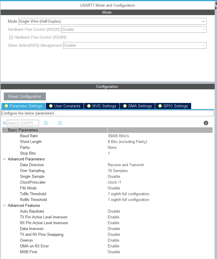

void MX_USART1_UART_Init(void)
huart1.Instance = USART1;
huart1.Init.BaudRate = 38400;
huart1.Init.WordLength = UART_WORDLENGTH_8B;
huart1.Init.StopBits = UART_STOPBITS_1;
huart1.Init.Parity = UART_PARITY_NONE;
huart1.Init.Mode = UART_MODE_TX_RX;
huart1.Init.HwFlowCtl = UART_HWCONTROL_NONE;
huart1.Init.OverSampling = UART_OVERSAMPLING_16;
huart1.Init.OneBitSampling = UART_ONE_BIT_SAMPLE_DISABLE;
huart1.Init.ClockPrescaler = UART_PRESCALER_DIV1;
huart1.AdvancedInit.AdvFeatureInit = UART_ADVFEATURE_TXINVERT_INIT|UART_ADVFEATURE_RXINVERT_INIT;
huart1.AdvancedInit.TxPinLevelInvert = UART_ADVFEATURE_TXINV_ENABLE;
huart1.AdvancedInit.RxPinLevelInvert = UART_ADVFEATURE_RXINV_ENABLE;
if (HAL_HalfDuplex_Init(&huart1) != HAL_OK)
Error_Handler();
if (HAL_UARTEx_SetTxFifoThreshold(&huart1, UART_TXFIFO_THRESHOLD_1_8) != HAL_OK)
Error_Handler();
if (HAL_UARTEx_SetRxFifoThreshold(&huart1, UART_RXFIFO_THRESHOLD_1_8) != HAL_OK)
Error_Handler();
if (HAL_UARTEx_DisableFifoMode(&huart1) != HAL_OK)
Error_Handler();
void HAL_UART_MspInit(UART_HandleTypeDef* uartHandle)
if(uartHandle->Instance==USART1)
/* USER CODE BEGIN USART1_MspInit 0 */
/* USER CODE END USART1_MspInit 0 */
/* USART1 clock enable */
__HAL_RCC_USART1_CLK_ENABLE();
The pin configuration is not generated here,
Is this a Bug?

‎2019-11-04 11:56 PM
​Hello @Swei.1885​ ,
Thanks for your feedback,
It will be internally checked.
Best Regards,
Khouloud
‎2019-11-05 1:31 AM
@Swei.1885​ Issue will be fixed in the next release.
Regards,
Khouloud​
