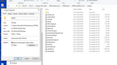

Hello @patm
Could you share the content of the STM32CubeMX\plugins\ folder and the access right given to this folder.
According to the log file some plugins (projectManager, filemanager, pinoutconfig) seems to be missing.
‎2023-12-20 3:47 AM
Please find attached.
