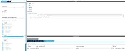

I'm using CubeMX 6.1.0 and CubeIDE 1.13.2 but the version of IDE should not matter as bug is already in the cubemx-generated code. Below you see the cubemx configuration part of NETXDUO:
In ProjectManager I selected:
It seems that this one is only appearing in Makefile-Mode. Nevertheless this is needed for our project.

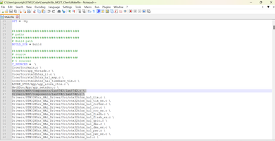

When I now "generate code" the produced Makefile has twice the source file of the network driver:
/home/pascal/STM32Cube/Repository/STM32Cube_FW_H5_V1.1.1/Drivers/BSP/Components/lan8742/lan8742.c \
which leads to:
usr/lib/gcc/arm-none-eabi/10.3.1/../../../arm-none-eabi/bin/ld: ../../Build/Release/lan8742.o: in function `LAN8742_RegisterBusIO':
lan8742.c:(.text.LAN8742_RegisterBusIO+0x0): multiple definition of `LAN8742_RegisterBusIO'; ../../Build/Release/lan8742.o:lan8742.c:(.text.LAN8742_RegisterBusIO+0x0): first defined here
Please tell me If I can post more needfull information. If you can't still reproduce I would generate a new project where I can post the corresponding files.
Best Regards Pascal

Here U R.
This is just a newly created STM32H563VIT6 with NetXDuo and ThreadX enabled and Makefile selected as output.
When generating code, the attached Makefile is the output where lines 46 && 47 show the malicous behaviour.

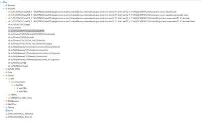

This error/problem has returned on Ethernet examples in CubeMX for the STM32H573I-DK.  However the makefile looks far different and does NOT have two lines relating to LAN8742.   The error message is: ...STM32Cube/Example/Nx_MQTT_Client/Drivers/BSP/Components/lan8742/lan8742.c:61: multiple definition of `LAN8742_RegisterBusIO'; ./Drivers/BSP/Components/lan8742.o:C:/Users/dbaker/STM32Cube/Example/Nx_MQTT_Client/Drivers/BSP/Components/lan8742/lan8742.c:61: first defined here
I am using STM32CubeIDE 2.0.0 and STM32CubeMX 6.16.0
Suspect .ioc, and makefile (renamed to makefile.txt) attached.

Hello @LostIon
Thank you for bringing this issue to our attention.
After checking the generated Makefile file , the line Drivers/BSP/Components/lan8742/lan8742.c \ is added twice to the project (NX_MQTT_Client example for STM32H573I-DK)
So a  ticket   222632   has been escalated to dev team to address this behavior.
