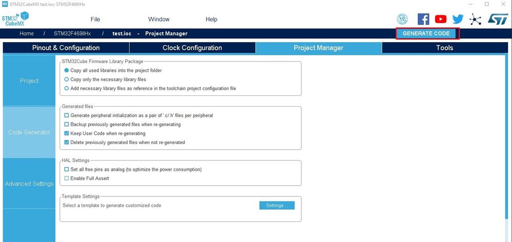

Terje Bøhler
February 13, 2019
Reg Q2 (do I get new code?)
How can I get updated my initializatin code (main.c)?
I did the following:
1) Doubleclick (lunch) my STM32CubeMX project file “X.ioc�?
2) From STM32CubeMX I changed GPIO-pin PB7 from todays configuration as an output pin with symbol name «PB7_200kHz_Pin» to a «Reset_state» (unused) pin – without any symbol name ("User label").
3) Then I do: Save Project As C:\STM\C93-Phase-2\C93-x19-FAT\ X.ioc
I here assumed the STM32CubeMX would generate an updated version of my inititialisation code (main.c). But my Keil MDK-ARM inititialisation code (main.c) is not updated. GPIO-pin PB7 is still defined as output – with label name «PB7_200kHz_Pin»
My Q is: How can I get the STM32CubeMX to generate new init code (main.c) containing the new GPIO configurations? I don’t see any “generate code�? feature in this STM32CubeMX tool? Have I overseen/misunderstood something?
I appreciate assistance ...
BR Terje Bøhler
February 13, 2019
In the right panel, there is "Generate code" button to generate your project.0690X000006DadOQAS.jpg
