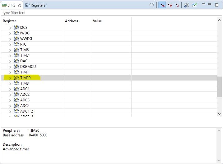

I have created a project for STM32F303REtx.
1° BUG: TIM20 is missing from the list of available timers. Instead in the "reference manual" and in the internal registers visible in debugging the TIM20 timer is present. See attached picture:
2° BUG: In the clock settings, for the TIM2 timer I have selected PLLCLK*2 in order to have 144 MHz (as is the case for TIM3/4 visible in the image).
At the time of setting, the correct indication (144MHz) occurs in the rectangle next to the word "TIM2". After saving the project, closing the project and opening the same project again, going to see in the clock configuration I always find "72MHz". In truth, the true clock at TIM2 is 144MHz, so it's just a data display problem, in fact the generated code is right.

‎2019-01-17 6:34 AM
Hello @WBOUG​
I wanted to say that both reported bugs are still present in STM32CubeMX 5.0.1.
Since you wrote "About 1° BUG it will be corrected in next CubeMX version" I was hoping this would happen (from 5.0.0 to 5.0.1).
Thanks
Andrea
‎2019-01-17 6:41 AM
Hello @Andrea Canepa​
datasheet table 2 and its associated note 1 indicates the contrary.
refman supports all component of the series and does not distinguish F303Rx or F303Vx for example
SVD file is unique for all F303 devices. this is why you can find Tim20 for F303Rx
Best Regards,
Wael
‎2019-01-17 7:31 AM
Hello @WBOUG​
you are right: on the data-sheet there is written what you say.
What misled me is that in the "Reference Manual" page 43, table 1, in the column called "STM32F303xD / E", on the "Section 20" line, reads "TIM1, TIM8 and TIM20". Since I have the "STM32F303RE" I thought it was the right column. I have not looked at the datasheet.
Furthermore, in the Debug of Atollic TrueStudio the TIM20 registers are present:
However now I understand: it is better to check the datasheet! ;)
Instead regarding the 2nd bug reported, do you have any updates?
Regards
Andrea
