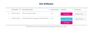

For STM32 U5, I can see two softwares - one is the package and other is the patch.
Patch for STM32CubeU51.1.1
STM32Cube MCU Package for STM32U5 series1.7.0

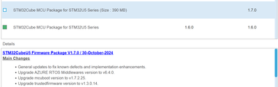

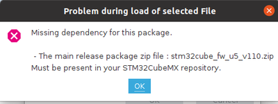

Following the process, I was able to install 1.7.0. But while installing the patch 1.1.1, I am getting errror -
My question - for the 1.7.0 is the patch 1.1.1 correct? Or the patch would be named as a progression to the base (in this case 1.7.1 ?). In that case, currently I don't need the patch after installing the firmware package of 1.7.0?
Or the patch of 1.1.1 on 1.7.0 is correct and some procedure I am missing here.
The latest package is 1.7.0. There is no patch beyond this.
The 1.1.1 patch is for the 1.1.0 version of the package.
