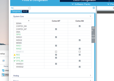

I have loaded default project for Nucleo-144 STM32H745ZITx, and want to customise for me unfortunately many options are grey ... are not editable ....?

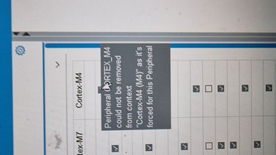

To understand why an option is grayed you can put the cursor on the grayed option and you will have details about why you can't use it.

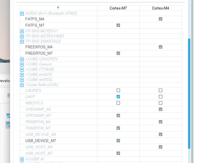

- project location is grey fix why ?
- I want to switch off Cotex-M4 to a large extent, does not work .... (does not say can remove ...)
