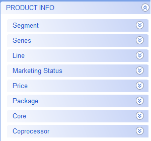

Had to actually register an username to comment this, but why does the UI has to change? :(
- The MCU/MPU selector has an error where after every character I type to the Commercial Part Number box the cursor automatically jumps to the box below.
- And the new UI just looks so 2008 to me... Why does that have to change? :( Now Cube looks like an ancient software made by a Japanese company that won't bother to adopt new tech.

Hello @LyHoangAn
In fact this is a known issue which is under investigation and described in the STM32CubeIDE Wiki.
BR,
