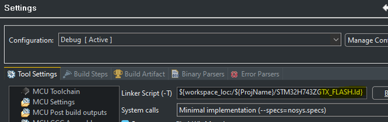

after updating to STMCubeIDE 1.15.0 the Linker Script (-T) settings are reset to default.

JensH
i have several different *.ld-files in my project and i use them depending on the selected configuration.
I don't know if the original file is replaced, because I don't use it.
If you do changes in the selected line they are reset after the version update.

This is happening to me too.
As soon as I upgraded to 1.15.0, code generation overwrites the linker script setting.
This is the setting as OP said, not the script itself.
Hope this gets patched quickly as it really messes up my workflow.
