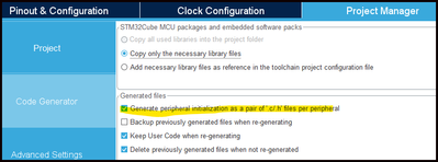

@AAlis.23 Your .ioc has "Generate peripheral initialization as a pair of '.c/.h' files per peripheral" checked.
This is why MX_LWIP_Init is placed in separate file lwip.c/h (along with other per-module files) rather than in main.c.
"Generate code" checkbox for LwIP is unchecked and "Delete previously generated files when not re-generated" is selected. So the remaining question is why lwip.c has not been deleted after re-generation. Maybe because it contains modified user code besides the MX_LWIP_Init().
These are actually two different things.
One is choosing to generate code as separate .c/.h files per peripheral, which is generally helpful when sharing peripheral code or changes across multiple applications. That option is intentional and beneficial in many scenarios.
However, a completely different matter is disabling the code generation for a specific module like LwIP. If I've explicitly unchecked the "Generate code" option for LwIP, then MX_LWIP_Init() shouldn't be generated at all, regardless of whether the code is structured in separate files or placed directly in main.c. That function simply shouldn't appear anywhere. This seems to be a clear bug in the application.
