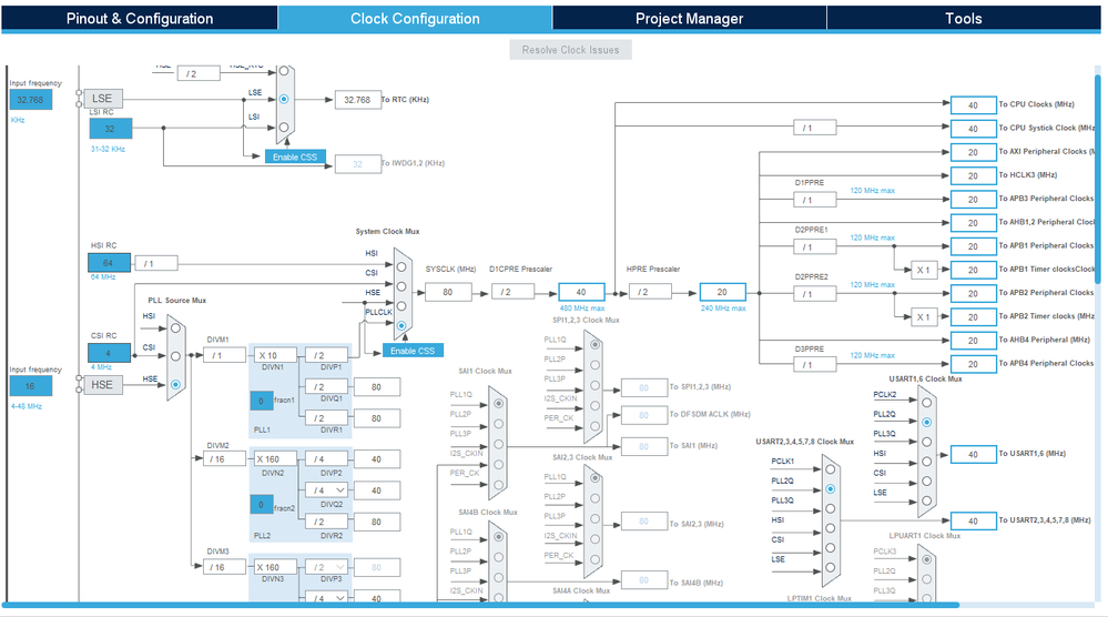

I run a generated code from stm32cube IDE with LL drivers, and the debug process stops.

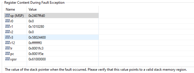

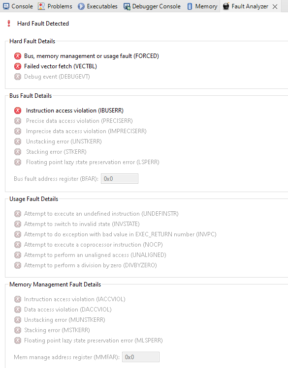

Did it hard fault? What do the hard fault registers indicate? Is HSE_VALUE used and set correctly?

0693W00000Lz8IOQAZ.png0693W00000Lz8ITQAZ.pngHSE is 16Mhz, it is configured correctly in clock
It is a custom hardware.

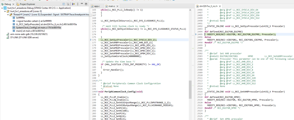

When I change from LL to HAL for RCC, the problem is solved.
I am using cube h7 1.10.0 and cube ide 1.9.0.

Yes, just select LL again for RCC peripheral.
Nikita91
Lead II
LL_RCC_SetSysClkSource(LL_RCC_SYS_CLKSOURCE_PLL1);
should be set AFTER
LL_RCC_SetAHBPrescaler(LL_RCC_AHB_DIV_2);
Intermediate AHB prescaler 2 when target frequency clock is higher than 80 MHz
