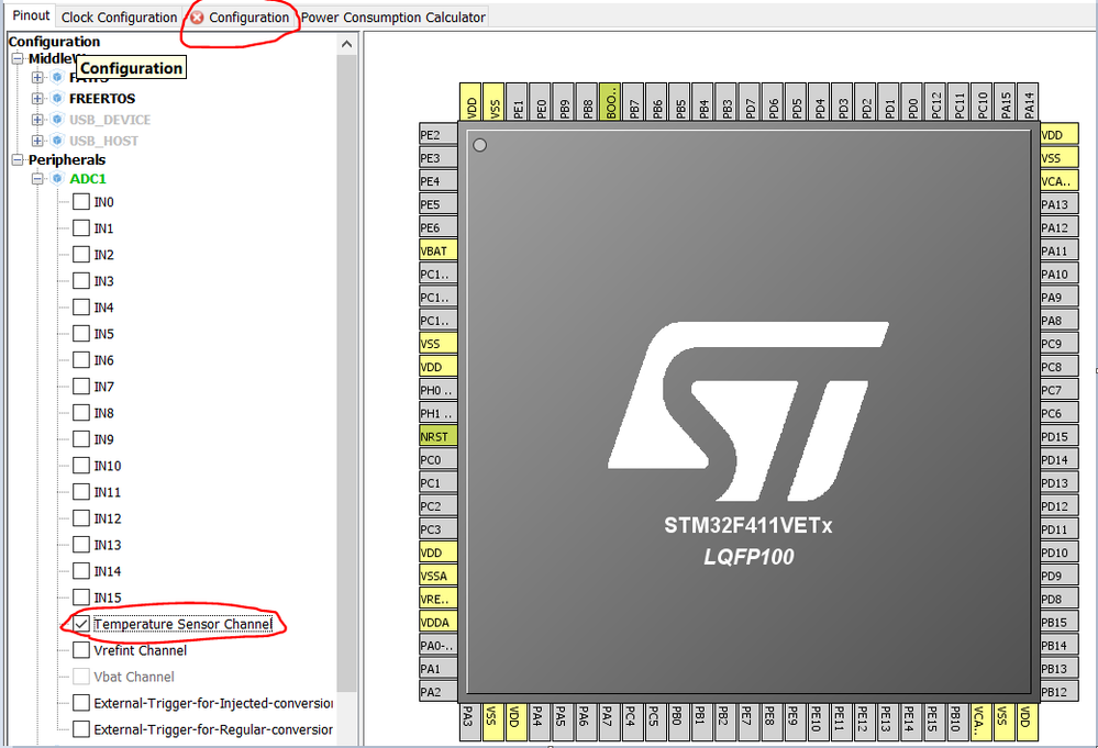

Hello!
After migrating to version 4.17 I have encountered problem with temperature sensor channel. I am working with it on a daily basis and I've never had any problems with it before.Problem:When i open fresh project with STM32F411VET6 and I enable Temperature Sensor Channel, I get a problem in configuration tab.Screens below.

Dear User,
Please note that your issue is reported internally for checking and working to resolve this. Best Regards STM32.forum

I can confirm this bug for a STM32F205 part as well.
stm32cubemx version previous to 4.17 did not have this bug.Options

I have same problem with ST32F746ZGT6 and ADC_CHANNEL_VBAT.

Fixed in 4.18.0
