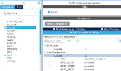

To temporarily fix this issue , simply activate only the user Configuration (as mentioned below).
It will have the same result of an empty project.
THX
