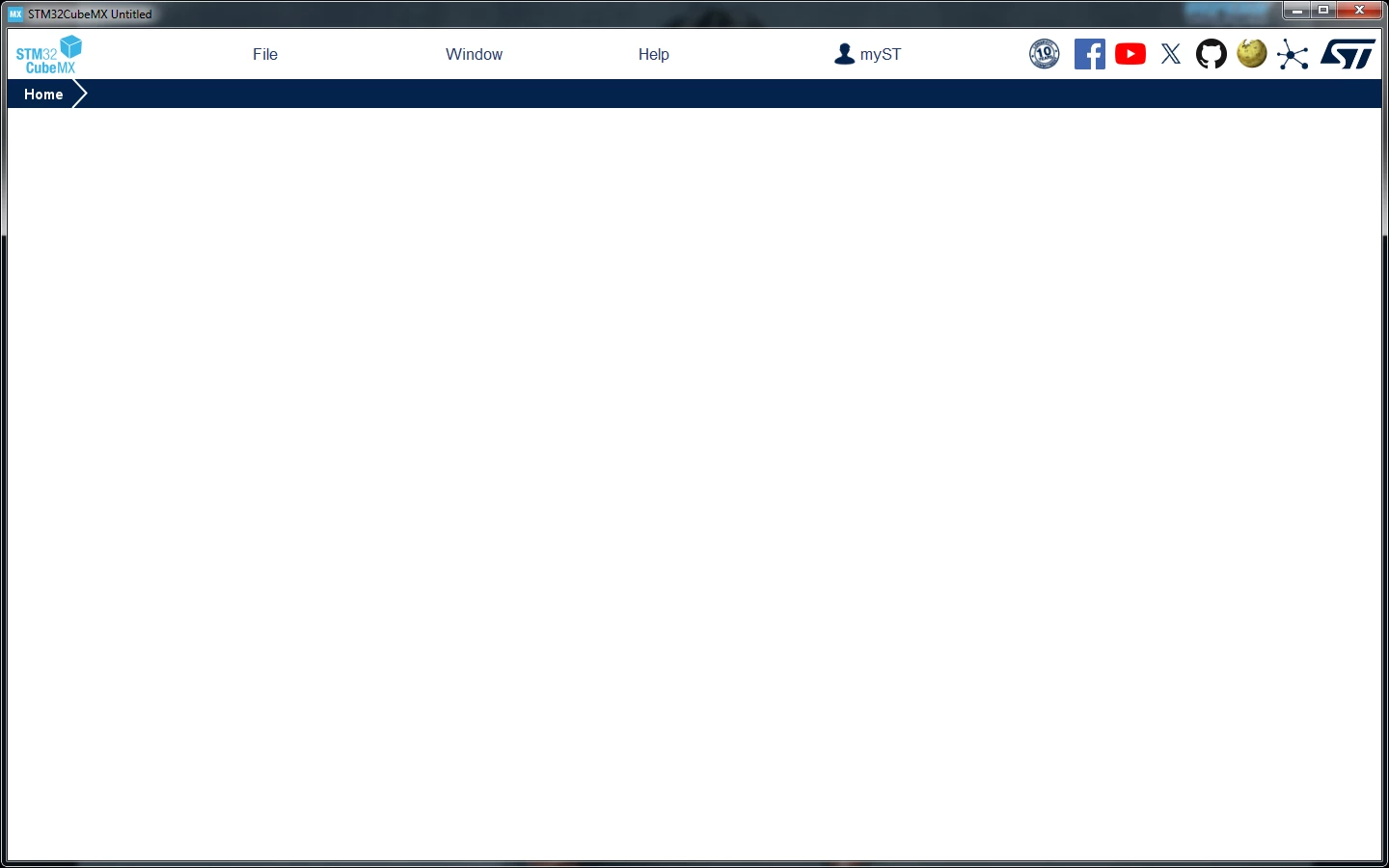

The fact, that the whole home screen is blank in my screenshot, suggests it could also be a web page, though a local one. I guess showing the 6 marketing/info images on the lower right corner was too hard for them to implement in Java...
But those are just my educated guesses.

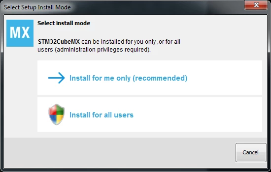

By the way, it is true that the installer of STM32CubeMX has been changed in 6.10.0: now it asks for private or shared installation, which gets rid of the administration rights if you choose the first one.
But unfortunately it is only available for Windows OS !
Does anyone know if this will be supported for other OSes soon ?

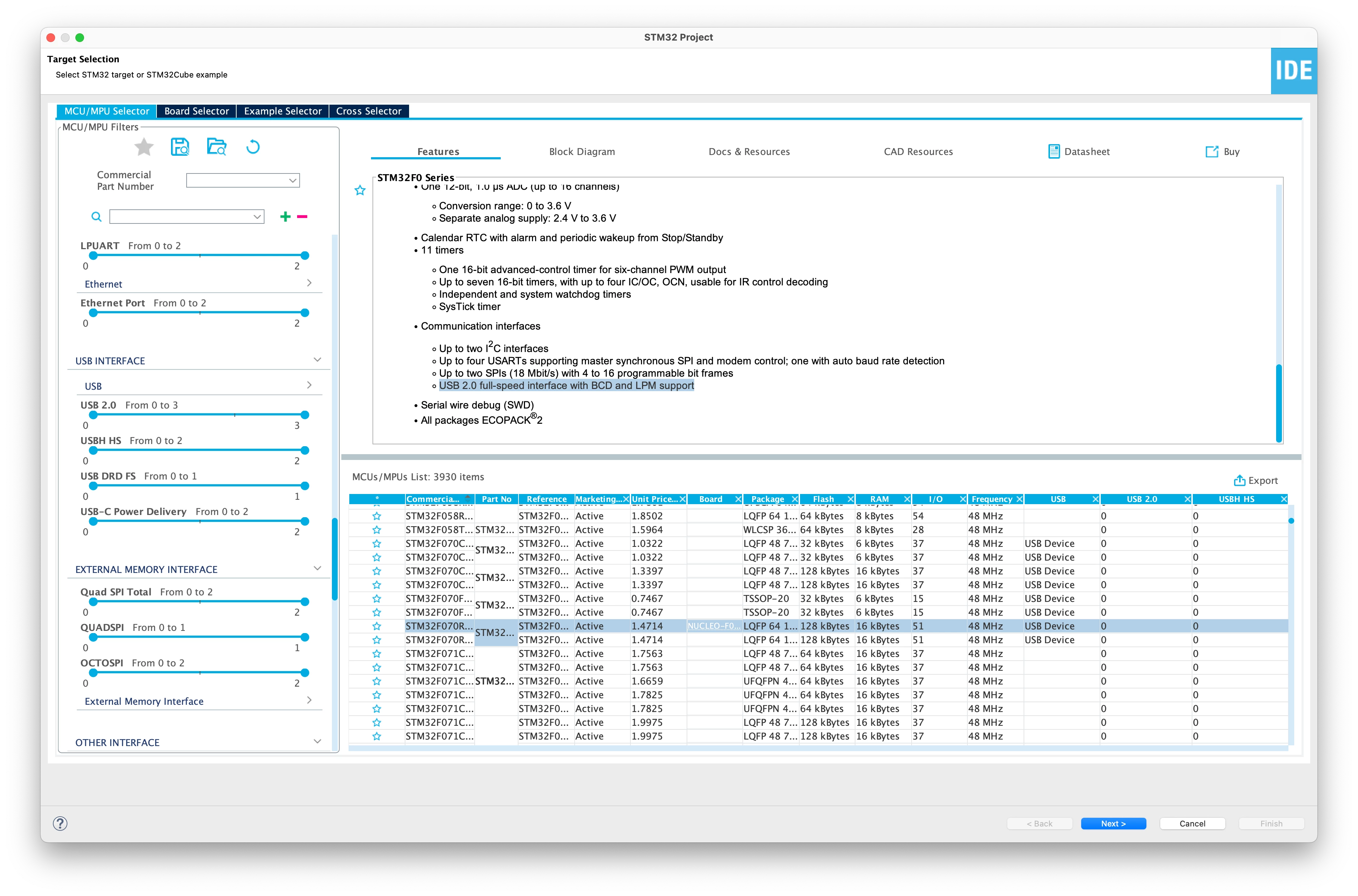

In STM32CubeMX 6.10.0 it is impossible to use sliders in order to filter out USB2.0 FS capable MCUs.
See screenshot.
- STM32F070RB has USB 2.0 FS
- there is no way to use filters (sliders) to pick out USB FS devices as all USB related numeric data fields for this MCU equals 0
-  only option to get USB FS MCUs at a glance is to enable USB column and sort by that

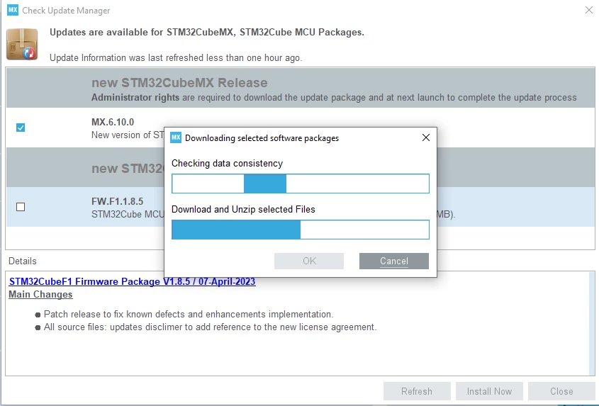

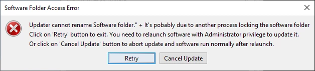

When trying to update Cube MX as per instructions at top of thread, I get through the download installation screen. All running as Admin.
It prompts me to restart. I restart, running as Administrator and I get the following message with the update failing.
Pressing Retry doesn't work. Can anyone from ST please advise?
Semer CHERNI
January 22, 2024
Hello @######
I need you to share the STM32CubeMX.log found under .stm32cubemx folder.
Also, originally which version of MX you are using and want to update.
KR,
Semer.
Senior II
January 22, 2024
Hello, whereabouts is the .stm32cubemx folder usually found please? I can't find it in C:/Program files, or in my user documents?
I'm currently using Cube MX 6.4.0 trying to update to 6.10.0 as described previous.
Senior II
January 22, 2024
@Semer CHERNI Please see attached.
Semer CHERNI
January 26, 2024
Hello @######
It seems like you did not start STM32CubeMX as admin the first time after you made the update. As it is necessary to complete the installation process. This is the scenario that made me see the same behavior as yours.
Senior II
February 2, 2024
Hello, I tried a few times. It finally worked once I stopped adobe acrobat running. Thanks for your help.
