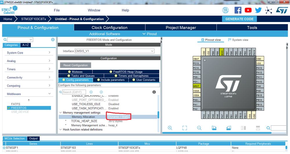

1- I Select a random MCU from the list of CubeMX , (STM32F103C8Tx). then i enable FreeRTOS and in the option I select "Dynamic/Static" for memory allocation.

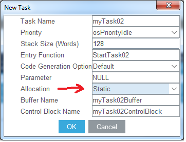

2- then I add a random task but I change the allocation to Static.

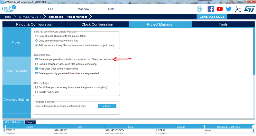

3- I select generate Peripheral init as pair of '.c/.h' files.
4- all other CubeMx options and Freertos options are left as their default. now I generate the project for MDK-ARM V5.

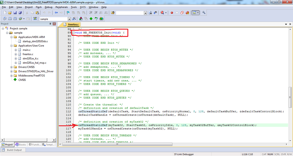

5- I open freertos.c in the project and as you can see the function MX_FREERTOS_Init() is there. (note that if you don't select generate as a pair of '.c/.h' this function is not generated this might have caused the confusion, however, the nature of the problem remains the same)
6- as you can see the function is called from the main function to configure FreeRTOS and Initialize the tasks and mutexes etc.
7- the macro
osThreadStaticDef(myTask02, StartTask02, osPriorityIdle, 0, 128, myTask02Buffer, &myTask02ControlBlock);

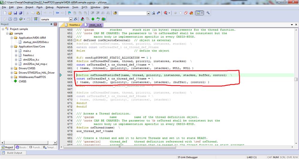

is inside that function. if you open the definition of the macro , you'll see it's just a wrapper to define different
const osThreadDef_t os_thread_def_##name
variables according to the tasks name. this variable holds everything about the task including the task buffer and task control block which is important to us.

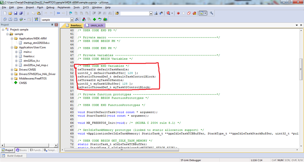

8- the task buffer and task block and other memory units are defined outside this function here :
which are possible to be extern-ed (declared) from other files (which we don't want to do.) however the
which translates into
const osThreadDef_t os_thread_def_myTask02 = \
{ myTask02, (StartTask02), (osPriorityIdle), (0), (128), (myTask02Buffer), (myTask02ControlBlock) }

10 - to solve this issue the user has to comment line 116 in file freertos.c in this example and move it outside the function.
