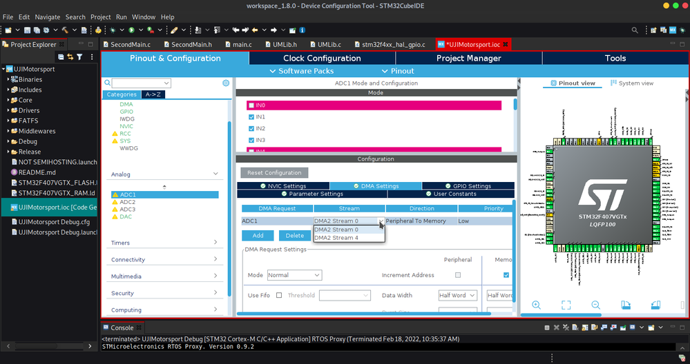

stm32cubeide won't let me select DMA1 with ADC periphereal
‎2022-02-18 2:00 AM
When adding a new DMA request to the ADC1 periphereal the only stream options available are DMA2 stream 0 and DMA2 stream 4. As I don't have any other DMA request enable I would expect to be able to select any stream from any DMA periphereal. Why is that I have this restriction?

‎2022-02-18 2:27 AM
These connections between peripherals are not "any to any". Check the reference manual for your chip, it should have a table for possible connections. That table should match what STM32CubeIDE is showing.
hth
KnarfB
‎2022-02-18 3:13 AM
According to RM0090 both dma controllers are connected to AHB2 peripherals (which ADC are). Tables 42 and 43 shows possible channel configurations, but I guess that not all possible configurations are listed there. So, how can I identify which channels are connected to each peripheral?
‎2022-02-18 5:37 AM
AHB2 - that's the data bus for ADC data, not those triggers you want.
Correct. That's it, nothing more. Same as STM32CubeIDE is showing.
hth
KnarfB
‎2022-02-18 6:31 AM
On the contrary, the table does show all possible configurations. The ones not listed are not options.
Newer families are not as restricted as the F4 in terms of stream assignments.
