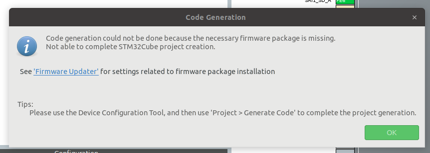

I imported a TrueStudio 9.3 project into stm32cubeide 1.0.0.
Everything was fine until i made a modification in CubeMx and regenerated code !!!
I had a code generation error then All my files and folder were deleted.
Yes i have a recent backup but that's really frightening !
Xavier

‎2019-06-03 6:10 PM
Hi, I too have been fighting with the integrated CubeMX. The deletion of files happens when the code generation cannot be completed and CubeMX has already started deleting files. After correcting the problem CubeMX creates only a clean project.
Think of having a big project and something like this happens when enabling another feature in CubeMX. Of course you should have a backup :).
