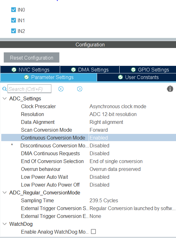

I'm trying to read ADC value from multiple ADC channels but reading the same ADC value for all channels.
This is my code snippet. Please support to fix it asap.

while (1)
/* USER CODE END WHILE */
/* USER CODE BEGIN 3 */
sConfig.Channel = ADC_CHANNEL_1;
sConfig.Rank = 1;
sConfig.SamplingTime = ADC_SAMPLETIME_239CYCLES_5;
if (HAL_ADC_ConfigChannel(&hadc, &sConfig) != HAL_OK)
Error_Handler();
HAL_ADC_Start(&hadc);
HAL_ADC_PollForConversion(&hadc, HAL_MAX_DELAY);
ADC_VAL[1]=HAL_ADC_GetValue(&hadc);
HAL_ADC_Stop(&hadc);
sConfig.Rank = 0;
Error_Handler();
sConfig.Channel = ADC_CHANNEL_2;
sConfig.Rank = 1;
Error_Handler();
ADC_VAL[2]=HAL_ADC_GetValue(&hadc);
sConfig.Rank = 0;
Error_Handler();

hadc.Instance = ADC1;
hadc.Init.ClockPrescaler = ADC_CLOCK_ASYNC_DIV1;
hadc.Init.Resolution = ADC_RESOLUTION_12B;
hadc.Init.DataAlign = ADC_DATAALIGN_RIGHT;
hadc.Init.ScanConvMode = ADC_SCAN_DIRECTION_FORWARD;
hadc.Init.EOCSelection = ADC_EOC_SINGLE_CONV;
hadc.Init.LowPowerAutoWait = DISABLE;
hadc.Init.LowPowerAutoPowerOff = DISABLE;
hadc.Init.ContinuousConvMode = ENABLE;
hadc.Init.DiscontinuousConvMode = DISABLE;
hadc.Init.ExternalTrigConv = ADC_SOFTWARE_START;
hadc.Init.ExternalTrigConvEdge = ADC_EXTERNALTRIGCONVEDGE_NONE;
hadc.Init.DMAContinuousRequests = DISABLE;
hadc.Init.Overrun = ADC_OVR_DATA_PRESERVED;

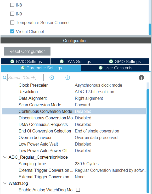

Hi @VDutt.1 and @DJack.8
From your code samples, I see you do not use the same STM32 MCU, but your issue is similar.
Note for Doug: STM32L0 and STM32F4 ADC have not the same features: on STM32L0, channel rank in the sequence cannot be configured, it is fixed to channel number.
The issue is due to overwritten data: when a sequence of several ADC channels is configured, in default configuration, a ADC start event makes ADC converts all channels successively in burst. Therefore, data register is overwritten by each new conversion data. If you do not fetch each conversion data on time, you get the only last one.
I propose 3 solutions to your problem:
1. Use discontinuous mode
In this mode, ADC does not convert all channels in burst but requires a ADC start event for each channel.
Setting: "hadc1.Init.DiscontinuousConvMode = ENABLE;"
Sequence principle:
HAL_ADC_Start(hadc1);
HAL_ADC_PollForConversion(&hadc1, <timeout>);
data_conversion_1 = HAL_ADC_GetValue(&hadc1);
data_conversion_2 = HAL_ADC_GetValue(&hadc1);
HAL_ADC_Stop(hadc1);
2. Poll for each conversion (not recommneded)
Not recommended, because of your CPU is busy at another task, then you will miss some conversion data.
Sequence principle:
<do not process anything else here !!!>
3. Use DMA transfer (recommended)
ADC converts all channels successively in burst and DMA transfers data in RAM (no CPU intervention).
Then user program can access all conversion data in a table: [data_conversion_1; data_conversion_2]
You can refer to examples in FW packages.

Hi Philippe,
I used your suggestion #1 and was able to sample two channels. However there are a couple of issues that concern me about the code. Below is my version of suggestion #1.
Issue 1.
If I comment off the lines:
if (HAL_ADC_ConfigChannel(&hadc, &sConfig) != HAL_OK) // required for code to sample both channels, why?
Error_Handler();
it stops sampling both channels. Likewise if I place a:
in the channel 0 section it stops sampling both channels even though I restart HAL_ADC later.
I attached the complete code as file. I am running this on a Nucelo-L031K6 board with the STM32L031.
Thanks for your help,
Doug
