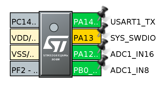

I'm trying to setup an USART for a very small MCU of the STM32G0 family, the MCU it's theoretically being programmed, but the USART is not responding, I configured the MCU just like I did in other projects (of bigger MCUs), I'm not able to find what I'm doing wrong in this case.
This is what I can see from the USART (theoretically in this image I'm sending "0xFF" all the time, but it does the same whatever I put in the buffer).
0693W00000YAa9tQAD.pngCodewise I'm enabling the USART DMA with LL_USART_EnableDMAReq_TX(USART1), then configuring with LL_DMA_ConfigAddresses.
Some checks with LL_DMA_IsEnabledChannel, and finally sending stuff with both LL_DMA_SetDataLength & LL_DMA_EnableChannel once the buffer has something on it.
Also tried to clear TC1 flag & disable channel every communication, checking it with LL_DMA_IsActiveFlag_TC1.
The USART is configured as Half-duplex (as it need to be) & baudrate, word length, etc...are correct: 0693W00000YAaAhQAL.png

Your polarity looks inverted. With TTL/3V level signals a UART should idle high. The start bit is initiated by a high to low transition. These images look like your line is idling low. Unless I am missing something, like you have a TTL-to-RS232 level shifter that isn't able to drive below 0V???? I don't know how that (inverted could happen in the G0, but then I don't know much about the G0 family.

I'm taking a look at it, everything is really weird. I managed to receive signals if I sent messages very quickly and it's very inconsistent, if I had a delay to sent messages every second then it's impossible to make it work and the signal you see it's like the one were talking about.
I don't understand anything.
Maybe it's just noise, what I see now looks like a word, but the characters are wrong. Maybe he's interpreting that the start or stop bit or whatever is in the wrong position.

STM32G031C6 has no SO8N in CubeMX.
The DMA in your above code is setup for receiving, not transmitting:
dma_init.PeriphOrM2MSrcAddress = (uint32_t)&USART1->RDR;
hth
KnarfB
In CubeMX I'm working with STM32G031J6Mx SO8N. I think that both chips are mostly the same.
Yeah, the disco board? For your above plots: double-check that you have probed the correct pins. On my disco, I have swapped RX and TX pins internally (CubeMX), so PB6 is free for SWD debugging. Make sure that TX is configured as push-pull PP, not OD by CubeMX.
Its also advisable to leave/config PF2 as NRST (option bytes), so you don't lock out yourself like several people here already did.
