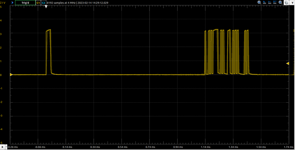

I'm trying to setup an USART for a very small MCU of the STM32G0 family, the MCU it's theoretically being programmed, but the USART is not responding, I configured the MCU just like I did in other projects (of bigger MCUs), I'm not able to find what I'm doing wrong in this case.
This is what I can see from the USART (theoretically in this image I'm sending "0xFF" all the time, but it does the same whatever I put in the buffer).

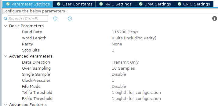

The USART is configured as Half-duplex (as it need to be) & baudrate, word length, etc...are correct: 0693W00000YAaAhQAL.png

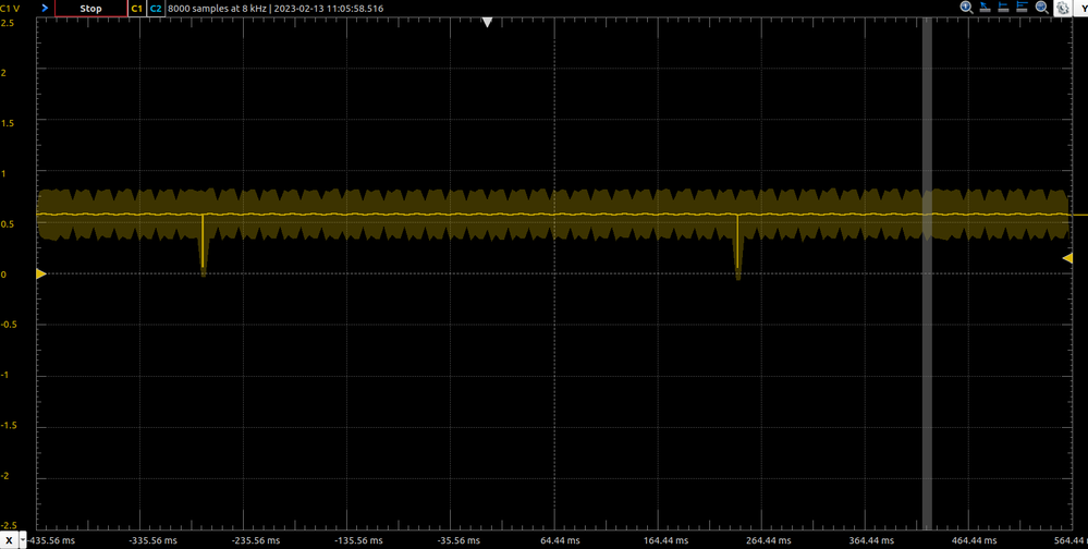

EDIT: If I remove the watchdog the "spikes" that go to 0 disapear.

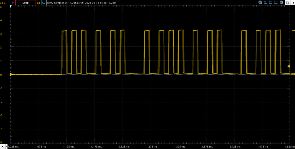

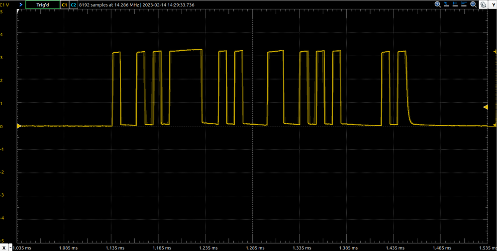

I built the project from scratch and I manage to sent data both with the DMA & HAL, now the problem I'm having is that the data I'm receiving it's not exactly correct, I'm receiving incorrect characters, I'll try to check if with an oscilloscope, but at a simple glance, everything looks good.
Also I would try again with my old code, as @KnarfB​ confirms that it worked with a very small change.
Edit: Well I just tried with USART_SendData code and I'm still receiving weird stuff.
fancyrat
Just as a reference, this is what I've got now, it should be saying "HOLA" using the UART with an DMA, I'm receiving other stuff mostly random symbols, I can't seem to find the relation to it:

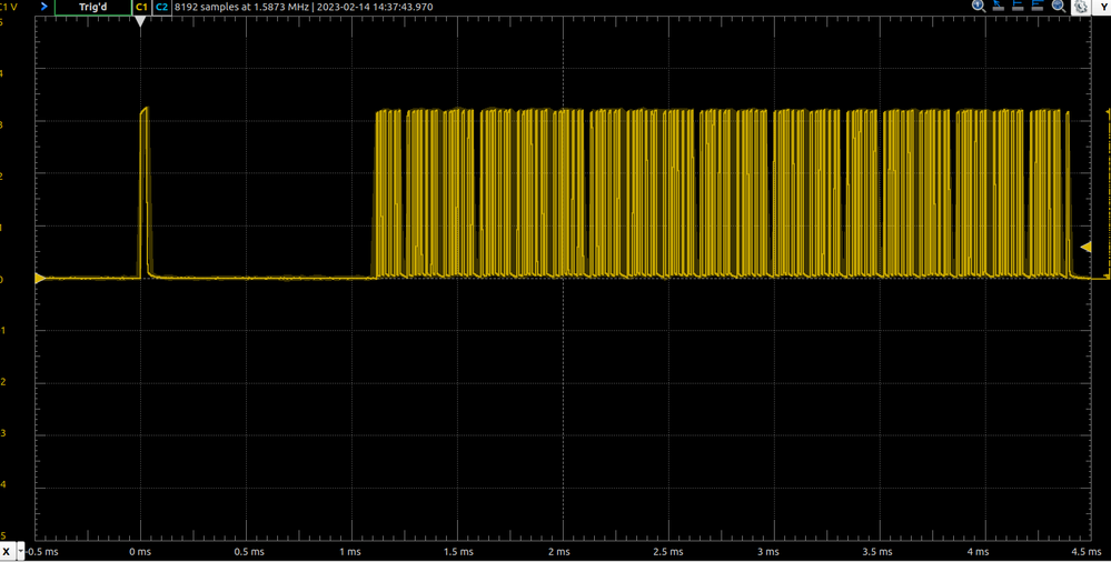

Now I've tried to write "*\n* just to have some other signal to compare like the one in this link: https://hackaday.com/2016/06/22/what-could-go-wrong-asynchronous-serial-edition/
It seems that in my case the message keeps repeating multiple times. But the bits are correct:
Viktor POHORELY
Do you have baud rate set correctly?
