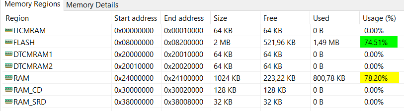

I am using IS45S16800F-7CTLA1-TR SDRAM. I added CubeIDE interface. External SDRAM size 128Mb==16MB but Built analyzer shows 1024KB. Why does it not true?
6 REPLIES 6
Mike_ST
This is the MCU's internal RAM that you are highlighting.
You have to define the additionnal memory region in your linker.
And setup the FMC controller before attempting access to it.

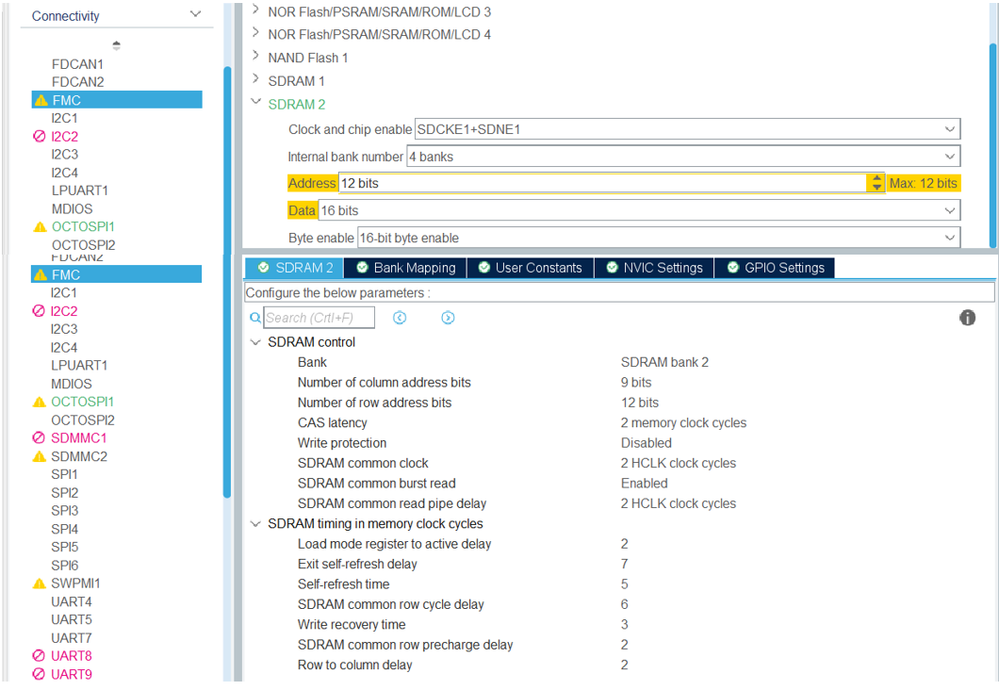

I set FMC setup parameters
I added below codes in main file
static FMC_SDRAM_CommandTypeDef Command;
  Command.CommandMode            = FMC_SDRAM_CMD_CLK_ENABLE;
  Command.CommandTarget          = FMC_SDRAM_CMD_TARGET_BANK2;
  Command.AutoRefreshNumber      = 1;
  Command.ModeRegisterDefinition = 0;
  HAL_SDRAM_SendCommand(&hsdram2, &Command, 0xfff);
  HAL_Delay(1);
  Command.CommandMode            = FMC_SDRAM_CMD_PALL;
  Command.CommandMode            = FMC_SDRAM_CMD_AUTOREFRESH_MODE;
  Command.AutoRefreshNumber      = 2;
  Command.CommandMode            = FMC_SDRAM_CMD_LOAD_MODE;
  Command.ModeRegisterDefinition = (uint32_t)0 | 0<<3 | 2<<4 | 0<<7 | 1<<9;
  HAL_SDRAM_ProgramRefreshRate(&hsdram2, 1542);

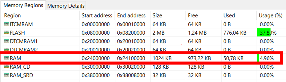

Before RAM activeted Built analyzer shows below

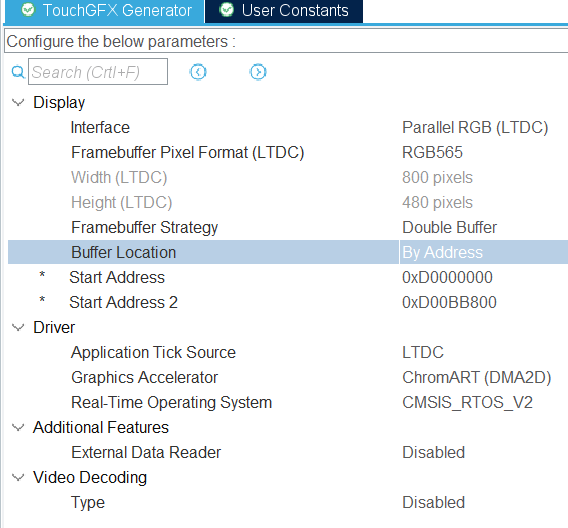

You need to add the external SDRAM region to your linker file if you want it to show up in "Memory Regions". But it doesn't really matter if it shows up there, it's still available to the chip once you configure it within your program.
This window isnt editable or based from wizards, when you add hw as sdram or qspi you need edit LD file ...
example
/* Memories definition */
MEMORY
  CCMRAM    (xrw)    : ORIGIN = 0x10000000,   LENGTH = 64K
  RAM    (xrw)    : ORIGIN = 0x20000000,   LENGTH = 320K
  FLASH    (rx)    : ORIGIN = 0x8000000,   LENGTH = 2048K
add here
  SDRAM    (xrw)    : ORIGIN = 0xD0000000,   LENGTH =16M
 and more edit for sections and use this memory in code, but your design will work without this if you manage and direct address this memory in code as for example in LTDC config
