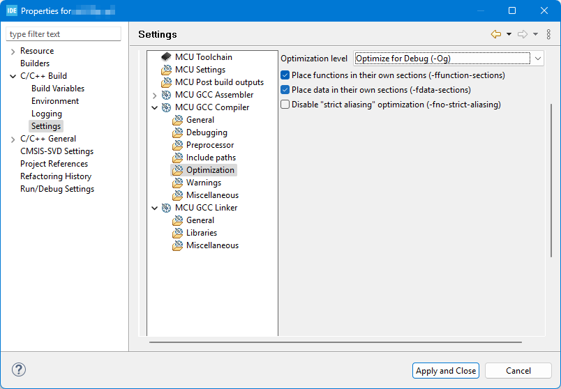

And another question for Ozone, where can I set the optimization level?
In the Project Properties (right-click Project name):
The options are documented here: https://gcc.gnu.org/onlinedocs/gcc/Optimize-Options.html
Where the IDE usually shows the build settings.
I don't use CubeIDE (which is basically Eclipse), but I suppose there is plenty of documentation and tutorials.
The debug and release configurations, which are usually created by default, have separate build settings.
You can have more configuration if you wish, each with different settings.
@FEber.1 and you can modify the built-in ones, if you wish.
The screenshot I showed is my modified "Debug" Configuration.

FEber.1
@Andrew Neil: Thank you very much. My surface looks a little different and I didn't find it straight away, although I was at this point at the beginning of the project.
