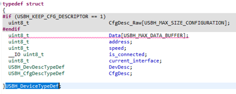

USBH_DeviceTypeDef has no member name 'CfgDesc_Raw'
in this line :
And when I go to the definition of USBH_DeviceTypeDef, I have this :
So if we want CfgDesc_Raw, it's because USBH_KEEP_CFG_DESCRIPTOR == 1 (and I checked, it's true), but if we don't have it in the structure, it's because the same macro != 1...
What happened ? Why can't I use this library properly ? Do you have any solution I can try, please ?

I could reproduce a compilation issue with Attollic, IAR and Keil but looks a bit different.
What is failing is the compilation of usbh_conf.c after adding the 2 lines in main.h
This seems to be linked to a recent change in code generation:
In generated stm32f4xx_hal_conf.h there is the line
#include 'main.h'
In older version of Cube there was instead
#include 'mxconstants.h'
If I remove this include main.h, compilation of usbh_conf.c is ok.
The error I get is:
In file included from ../Inc/main.h:49:0,
from ../Inc/stm32f4xx_hal_conf.h:43,
from ../Drivers/STM32F4xx_HAL_Driver/Inc/stm32f4xx_hal.h:48,
from ../Drivers/CMSIS/Device/ST/STM32F4xx/Include/stm32f4xx.h:245,
from ../Inc/usbh_conf.h:55,
from ../Middlewares/ST/STM32_USB_Host_Library/Core/Inc/usbh_core.h:37,
from ../Middlewares/ST/STM32_USB_Host_Library/Class/MSC/Inc/usbh_msc.h:37,
from ..\Middlewares\ST\STM32_USB_Host_Library\Class\MSC\Src\usbh_msc.c:42:
../Middlewares/ST/STM32_USB_Host_Library/Core/Inc/usbh_def.h:281:44: error: 'USBH_MAX_NUM_ENDPOINTS' undeclared here (not in a function)
USBH_EpDescTypeDef Ep_Desc[USBH_MAX_NUM_ENDPOINTS];
Actually usbh_conf.h which defines the
USBH_MAX_NUM_ENDPOINTS is itself including stm32f4xx.h which leads to include main.h. So in main.h you include a header file
As a workaround I would suggest adding your lines in the main.c file if possible or create another header file if you need to share this with another source file.
