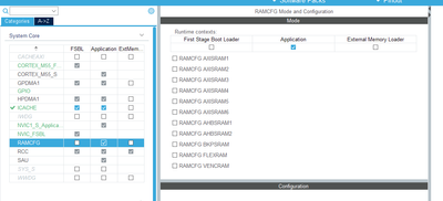

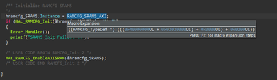

Did you enable the ram regions?
RAMCFG_HandleTypeDef hramcfg = {0};
hramcfg.Instance = RAMCFG_SRAM3_AXI;
HAL_RAMCFG_EnableAXISRAM(&hramcfg);
hramcfg.Instance = RAMCFG_SRAM4_AXI;
hramcfg.Instance = RAMCFG_SRAM5_AXI;
hramcfg.Instance = RAMCFG_SRAM6_AXI;
UnfgrAuthor
Jun 23, 2025 4:22 PM UTC
You mean this one in GUI? no..... it would have been too easy and too logical to do so!
I may have been chasing my tail these last days!!!!  {***... this brings back memories of "sleepless debuging nights for the lost EOL!"}. I will be testing tommorow and report back!
Kudos once again :)

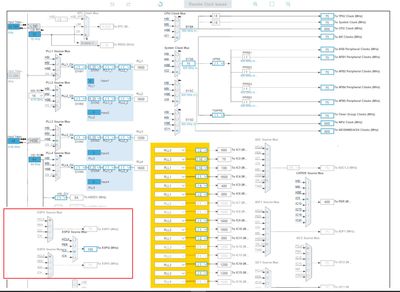

Well it looks like, it was partially hardware issue and part software.
I managed to read/write the external flash by decreasing -some- clocks [with some of them having nothing to do with flash.... but whatever!!!!]
Here, i'm attaching the maximum (found by trial & error) clocks in order to run the NPU and have access to external flash. Keep in mind that high speed OTP for flash (VDDI3 level) is enabled and 1.8V level is also enabled in software!
Now the issue i have is that i'm trying to fill the model input buffer with random data in order to verify that it works but i cannot write to buffer (for some reason everything remains zeroed).
Any idea anyone? (i'll also make a new post since this is a totaly new problem)!

So.... it is a problem with CubeMX code generation (broken memory init)
https://community.st.com/t5/edge-ai/ml-model-input-buffer-problem/m-p/817906#M5046
