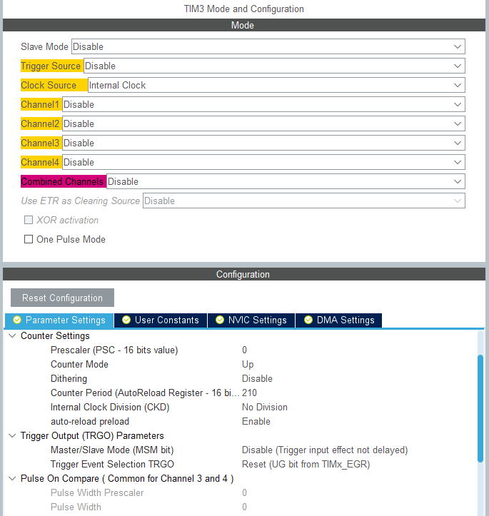

Timer3:

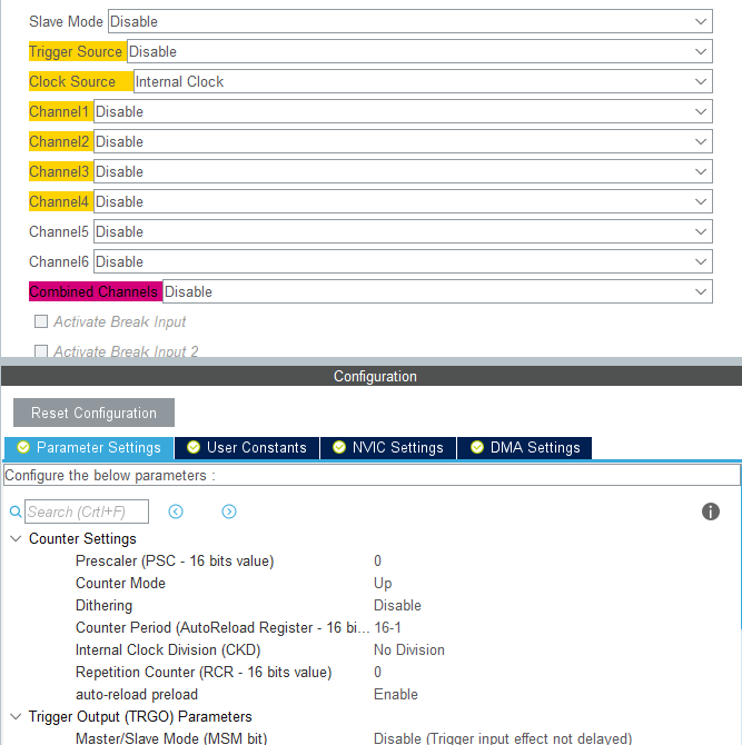

Timer1

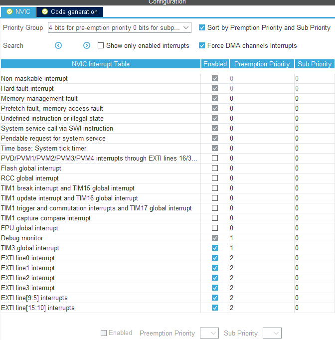

NVIC:

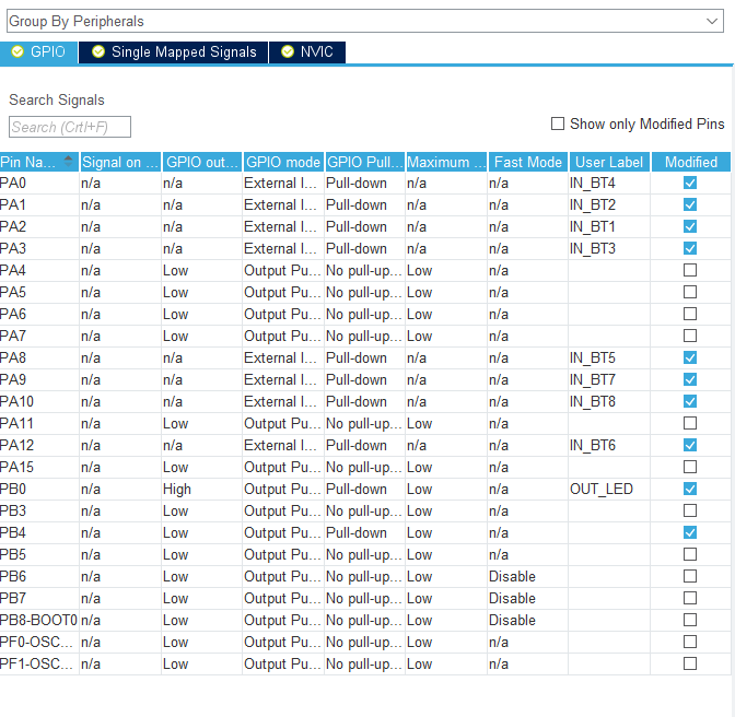

GPIO:

It's probably stuck in TIM3 interrupts given that your period is only 210 ticks. Run the code, hit pause, then see where the MCU is at.
