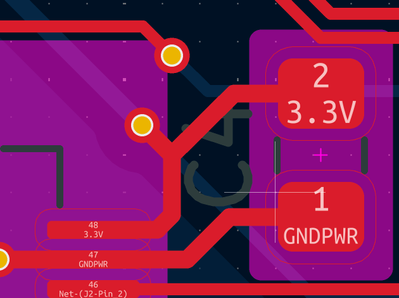

Been working on this for a few weeks now, I'm losing my mind. In STM32CubeIDE, only time I can get anywhere is in hardware reset, and there it times out. In STM32CubeProgrammer, it does connect. It can read the MCU name, flash size, all of that. All addresses read 00000000. However, I can't write in the programmer, and I just can't figure out why. Write to memory failed. Failed to erase data. Failed to download data. This is my first time doing something like this, so maybe I'm missing something. But nothing I've looked up has helped.

Don't know how much this will compress, but this is what I've got. All VCC connected, and reading 1.12 across the 4.7 cap.
Only see 1 VSS pin in the schematic. Are the other 3 VSS pins 31, 47, 63 connected to ground? Where?
Otherwise things look good.

They are all also connected to ground, with the 100nf caps. That long line to the left of the chip.
I only see VDD pins on the left side of the chip, not VSS.

 They're all connected like this. Sorry, I think the footprint just combined the pins into one output. But I have all 4 VSS and the one VSSA pins connected to ground.
Probably an issue with power then. Monitor NRST if you can, maybe it's resetting. Perhaps bad solder joints or some other workmanship issue is the cause. Schematic otherwise seems good.
All signs point to a hardware issue. Not going to be able to solve that with STM32CubeProgrammer settings.
