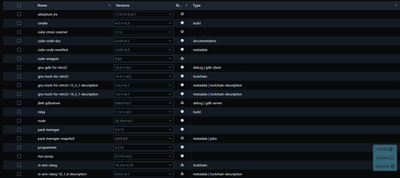

Question 1

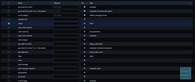

The first image shows the toolchain configuration of my previous project, and the second image shows the configuration displayed in my newly created project. Why do I need to reinstall the toolchain when creating a new project on the same computer?
Question 2

According to me first snapshot shows your first project setup i.e. tools locked / assigned to this project.
Second snapshot shows what tools are installed on your local system ... no the ones locked / assigned to your second project.
Comparing pears and apples here.
Assigning tools to a project is for sure not requiring to install them back. They are already on your system what's fine. Assigning / locking is just making explicit which tools your project has to rely on. You may want to use one toolchain for a project, another for the second etc etc.
Assigning / locking tools to a given project is populating for you under the hood the local $PATH variable ...

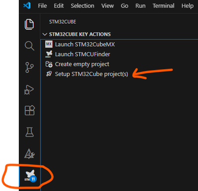

In short one setup step is missing to you for your second project. Let's have a try to force it:

There is a system wide bundles store and a per-project list of used tools (bundles).
Both can be viewed via the bundles manager view.
Your second screen print seems to show the system wide bundles store.
