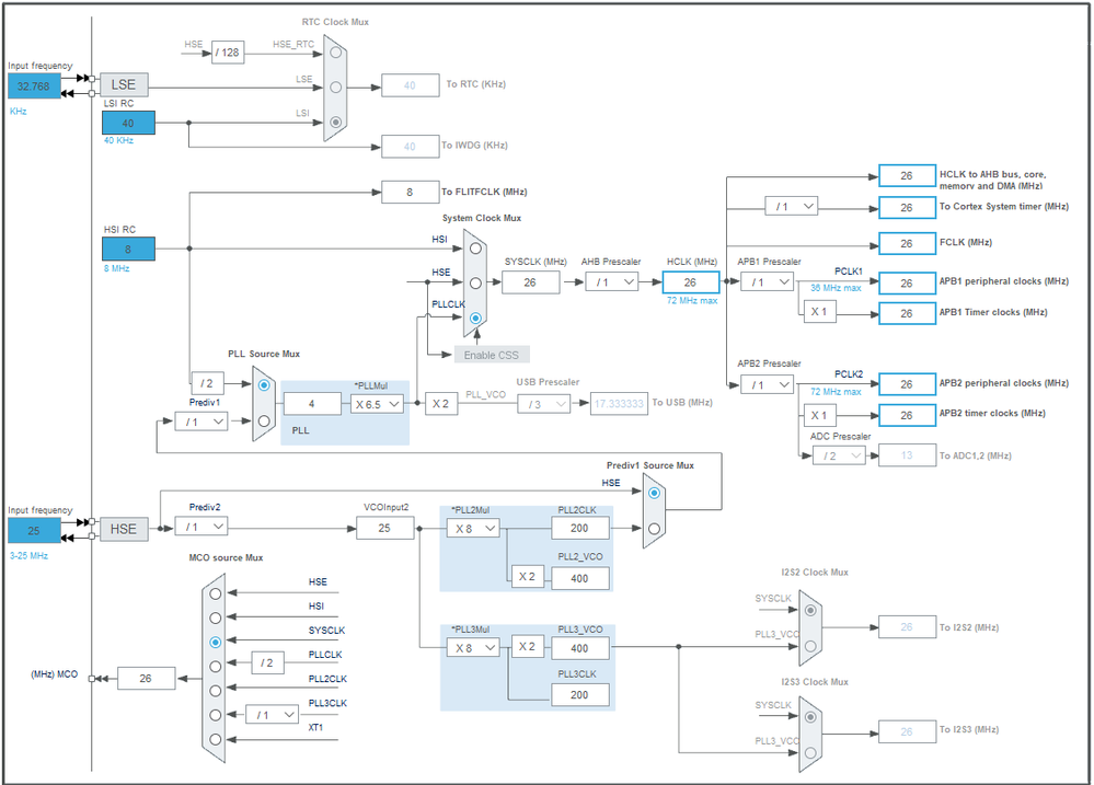

I have a project using a STM32f107VC which I am trying to update and I run into some problem configuring the clock in the updated environment
So I tried to create a simple project using Stm32CubeMX and I still can't configure the clock properly.
I added code to my main application that blinks a led with delay of 1000 ms but the LED actually blinks every 2000ms (checked with a scope)
I generate an Other Toolchains (GPDSC) project in the CubeMX and then import it to Visual GDB 5.4r12
the project information is :
Stm32CubeMX: version 5.3.0
MCU:  STM32F107VCTx
Firmware: STM32Cube FW_F1 V1.8.0
This is the clock configuration:

seems to be a problem in HAL_RCC_GetSysClockFreq()
in file VisualGDB\EmbeddedBSPs\arm-eabi\com.sysprogs.arm.stm32\2020.01\STM32F1xxxx\STM32F1xx_HAL_Driver\Src\stm32f1xx_hal_rcc.c
there is special handling of the case where *PLLMUL=6.5 where the code multiplies by 13 & later divides by 2 using this code:
    if (pllmul == aPLLMULFactorTable[(uint32_t)(RCC_CFGR_PLLMULL6_5) >> RCC_CFGR_PLLMULL_Pos])
     pllclk = pllclk / 2;
the problem is that this is NOT done if the PLL source is RCC_PLLSOURCE_HSI_DIV2
so the calculated SystemCoreClock is wrong
this is a bug in the visual gdb library, not STM cube!
