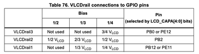

I’m setting up a new project in STM32CubeMX for an STM32L073RZ using the internal LCD controller in 1/3 bias mode.
According to the STM32L0 reference manual (RM0367), the LCD voltage rails should be configured as:
PB12 - VLCDrail1
PB2 - VLCDrail2
However, in STM32CubeMX, the GPIO configuration only allows:
PB12 - VLCDrail2
PB2 - VLCDrail2
There does not appear to be any option to configure either pin as VLCDrail1.
Am I misunderstanding the LCD rail configuration for 1/3 bias mode on STM32L073RZ, or is this a limitation/bug in STM32CubeMX?
