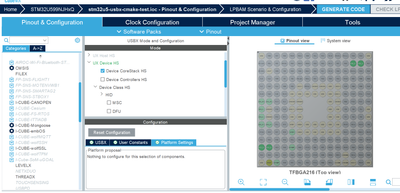

After checking the provided project  https://github.com/mrubli/stm32u5-usbx-cmake-test
You did not select the device controller HS. As a result, MX did not generate the file in the CMakeLists.txt.
If you need to use the file, navigate to /Middlewares/ST/usbx/common/usbx_stm32_device_controllers. You need to select usbx -> ux Device HS -> Device Controllers "

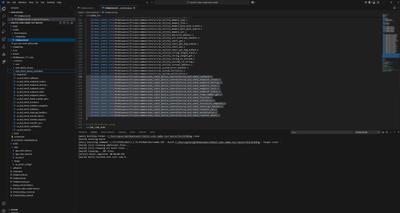

Missing files in cmake/stm32cubemx/CMakeFiles.txt.
In project.zip i added a cleanly generated project using the exact same ioc i have in my project. No .c files under this folder are included in the project.
I am using STM32CubeMx version 6.14.0. on windows 11
Steps:
1. coppied ioc to new folder
2. opened ioc with cubemx
3. generated clean cmake project
4. imported project to vscode
5. build project - success
6. added `ux_dcd_stm32_initialize(0, 0);` in USBX/App/app_usbx_device.c:MX_USBX_Device_Init()
7. build project - fail
8. added *.c files to sources in ./CMakelists.txt
9. build project - success

I ran into the exact same problem but deleting ~/.stm32cubemx didn't fix it for me. I'm also on CubeMX 6.14.0, running Linux.
For what it's worth, here's a sample project illustrating the problem:
Obviously, re-generating the code in CubeMX overwrites the manual addition of the missing source files in CMakeLists.txt (the last commit), so it's not a proper solution.
@FBL What was the outcome of your internal ticket? Is this a confirmed bug and your earlier suggestion is merely a workaround? Or was the team unable to reproduce the issue? Anything else I can try?

No it didn't, which CMakeLists.txt did you change, because the CMakeLists in main folder isn't overwriten
MR5
Thanks, then we're still waiting for a solution from ST. I would have been very surprised if just clearing .stm32cubemx fixed it because the problem is reproducible across machines.
Right, I had to change cmake/stm32cubemx/CMakeLists.txt in the example. For my actual project I'm likely going to just post-process the generated file because this isn't the only problem I'm having with generated CMake files.

Hello @MR5
