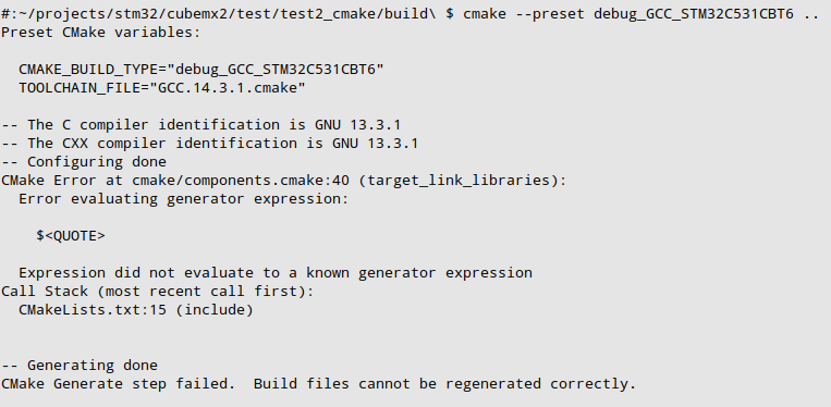

when generating cmake file from CubeMX2, CMakeLists.txt states:
cmake_minimum_required(VERSION 3.20)

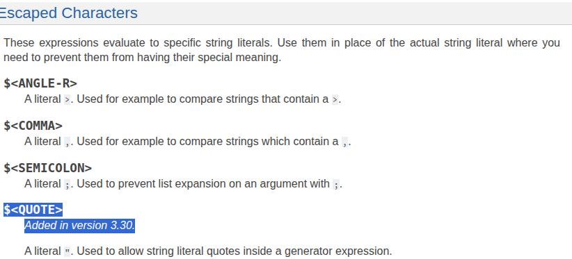

but in fact you need a minimum version of 3.3:

The issue is caused by the following lines in stm32c5xx_dfp/CMakeLists.txt:
# Include RTE_Components.h globally if needed
if(CMSIS_Tcompiler STREQUAL "IAR")
    target_compile_options(STMicroelectronics_stm32c5xx_dfp_2_0_0 INTERFACE "SHELL:--preinclude $<QUOTE>${CMAKE_CURRENT_LIST_DIR}/RTE_Components.h$<QUOTE>")
else()
    target_compile_options(STMicroelectronics_stm32c5xx_dfp_2_0_0 INTERFACE "SHELL:-include $<QUOTE>${CMAKE_CURRENT_LIST_DIR}/RTE_Components.h$<QUOTE>")
endif()
It can be fixed quite simply by changing the lines slightly to use an escaped quote (\") instead of <QUOTE>. This keeps compatibility with older versions:
