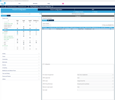

  • Generated a CubeMX project
  • Enabled FSBL, Secure Application, Non-secure Application and ExtMemLoader projects
  • Enabled XSPIM, XSPI2, EXTMEM_LOADER, EXTMEM_MANAGER

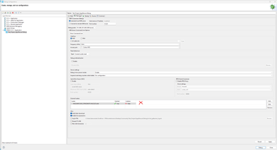

And this is where I get stuck. Since the project generates 4 sub-projects, which one do I run and on which boot configuration (BOOT0 JP1 and BOOT1 JP2)?
I just want to get the non secure application to run, I have added a line of code to turn the blue LED on to verify that the code is running. Purpose of this project is to understand the project structure and its method to get the code running.
Can someone please describe the steps I need to follow and in which order these needs to be done?

You should set the Pin Context assignment to Non Secure Application.

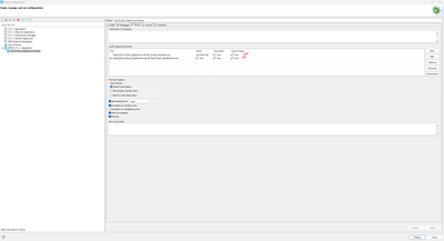

Build  both project Secure and Non-Secure.
Set the External loader.
Add the AppliNonSecure.elf.

The problem was that I was flashing the FSBL project and then my non-secure application and therefore the LED in the non-secure application was not blinking. The solution was to first load the FSBL project, then the secure project and then the non-secure one.
