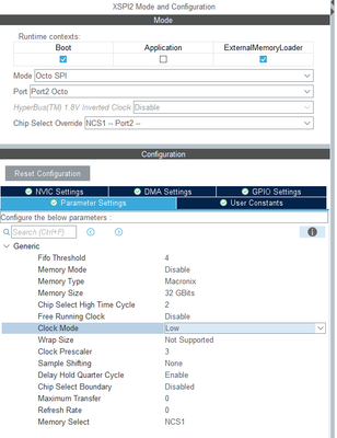

I created a Boot/App/ExtMemLoader project for my NUCLEO-H7S3L8 via the STM32CubeMX for STM32CubeIDE, and ran into issues when running the application code from the external NOR Flash chip on the NUCLEO board (U18, P/N MX25UW25645GXDI00 on the schematic).  The Boot and ExtMemLoader applications run just fine.  However, the App would not run with the default config generated in STM32CubeMX.  Screenshot here:

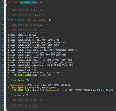

After changing the FifoThresholdByte to `1`, setting the size to 256Mbit, and reducing the XSPI clock to 180MHz, I was able to get the application to run.  I probably should double-check which of these settings are necessary.  Although I can now have it execute the Application from the external FLASH, I am now running into issues when setting breakpoints and debugging the application.  The debugger stops responding entirely, and I have to kill the GDB instances in order to recover.

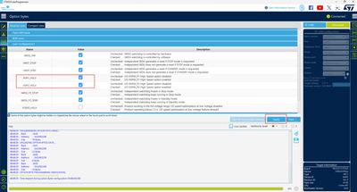

I suggest that you connect the NUCLEO-H7S3L8 board with STM32CubeProgrammer and under Option bytes:
User Configuration1:
Enable XSPI1_HSLV and XSPI2
Thanks.

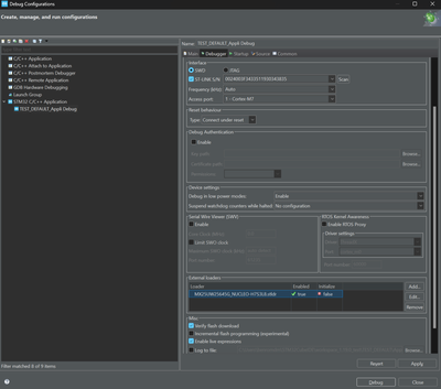

Thank you, @Mahmoud Ben Romdhane .  I have already checked XSPI2_HSLV, such that the debugger can program and run the application.  However, I did not need to enable XSPI1, since the NUCLEO only uses XSPI2 (per the schematic).  Other than that, I did verify my debugger configuration against your screenshots.

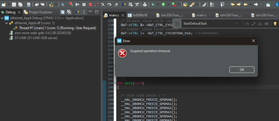

The issue then manifests when I run GDB with the application.  After STM32CubeIDE finishes flashing the Application, I then issue a `monitor reset` and `continue` in the GDB console.  Then while I run the application, I attempt to set break points or pause the debugger, GDB locks up and won't respond anymore.  It doesn't always happen on the first try, but most of the time it does occur on the first try.  If not the first try then GDB will eventually hang.
I had a similar issue a couple months back, where I was running from internal flash/SRAM and I needed to disable the MPU protection.  Note, I do not have the MPU enabled in Boot/ExtMemLoader/App.
I've attached my main.c, and here is a screenshot of the debugger issue.

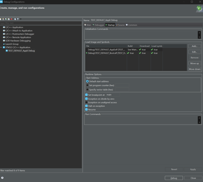

@Duc Thank you!  This helps tremendously.  I just wasn't very familiar with using the IDE to program both the bootloader & application (I was doing it by hand previously).  I also compiled my own stdlr which I was using, but apparently didn't need to.  Also, I didn't know I could configure the debugger to load both the bootloader and application like that.  That saves me a ton of headache.  Thank you!
