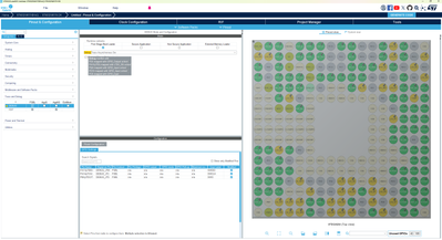

I would like to say that this is not a CLion problem. I only mentioned it because of the context. I would like to describe this as a problem when I am trying to use the command line tools from ST instead of running all in the CubeIDE. I am getting this error when starting my application using the command line tools to debug. I have been able to successfully debug the application when clearing all pin-assignments in the CubeMX tool before using the generated code, but because I thought that I could let the default assignments be when running this on the Discovery board results in the problem described.
Is there some default assignment that could be a conflict with debugging?
Thanks,
Mats
Hello @nilssonm
As shown in the following screenshot
CubeMX is warning about a debug conflict:
Debug Conflict with:
PE0 mapped with GPIO_Output and
PA15(TDI) mapped with ULTCD_RS and/or
PA05 mapped with GPIO_input and/or
PD0 mapped with GPIO_input and/or
PD1 mapped with GPIO_input
This prevents the debugger from working because the hardware cannot use the same pin for both debugging and another peripheral at the same time.
This is the root cause of your "Target not halted" and ST-LINK errors.
CubeMX is intentionally designed to offer flexibility, allowing you to customize or reassign pin functions according to your project’s requirements. While it provides warnings about such conflicts, it leaves the final decision to you.
THX
Ghofrane
