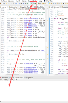

I don't know what happens, I just restarted my laptop, then it does not run or debug from CubeIDE. Before I retarted the laptop, I was debugging.When I click to Run or Debug, there is nothing appearing in the console window.  I closed the IDE twice, but nothing changed.
Anybody knows how to resolve this issue?

Where, exactly, do you click?
On this icon:
press the little down-arrow - is/are you debug config(s) listed?

I cleared the console, and then clicked on Debug button or Run button as shown in the following picture, nothing happens:
I have not seen any error message so far.
I have worked with CubeIDE for years, and this is the first time I come across this issue.
My laptop has 16GB memory running 64bit-windows 11 or 12.
I alway click on the bug icon which will launch the debugger for the project listed on top, also for run icon. I also tried to click on the arrow and select the project on the top, but nothing happens in the console window.
I can also see a message of "Launching Tunnel: 0% with a progress bar flashing away quickly, this means I did click the bug icon successfully.

I clicked on most of the following icons, they all work except for the Debug and Run:
Before I restarted the machine, I was working with the debugger, I found my Serial Port Assistant software didn't work properly (it didn't print debugging text messages from my F767 board any more), so I decided to reboot the machine to resolve the issue (this usually works before), so I did the reboot, but when I launched the CubeIDE I found I can't run or debug from the IDE any more.
I closed the IDE then deleted the file you suggested, start the IDE, click on Run or Debug icons, the issue is still there. Other icons work fine.

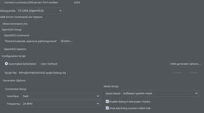

Other experimental try...set debug to OCD , then try again .
