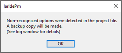

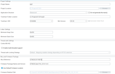

I am using NUCLEO-C071RB development board ,I am generating the code using CUBE MX software(V6.14.1) following steps I have followed
Step 1:Selected the board as NUCLEO-C071RB
Step 2:From project manager I have selected the Toolchain/IDE as EWARM and other configuration as below
Step 3:Clicked on generate code
Step 4:a .eww file is generated and I opened the file using IAR software the code builds completly without erros but, I am getting the following notification during opening of file

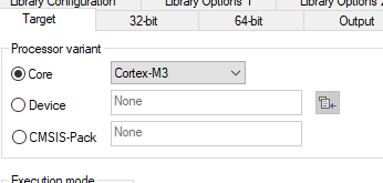

Step 5:The code builds ok with no error so now I have tried to debug that code it will not
Step 6:I have right click on project and tried to look the core or device but it is not detected as below (the core should be Cortex MO+and there should be Device name
My question is: Could there be an issue with the CubeMX IDE that's preventing it from detecting the STM32C071RBT6 microcontroller?

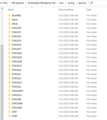

Step 7: I navigated to the ST folder in the IAR system, but I couldn't find any files related to the STM32C071RBT6. Why weren’t the files generated

@curiocity wrote:Step 4: a .eww file is generated and I opened the file using IAR software the code builds completely without errors but, I am getting the following notification during opening of file
What do you mean by, "opening the file" here ?

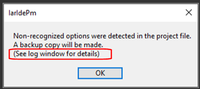

‎2025-06-02 3:18 AM - edited ‎2025-06-02 3:21 AM
Thanks, but you didn't say what host - windows, linux, etc ?
@curiocity wrote:2.Opening the file means that the generated .eww file is launched using IAR Embedded Workbench.
Your title says, "during debugging" - but that sounds like just initially opening the project file?
PS:
What did the log window say?

‎2025-06-02 3:27 AM
IAR WB was Windows-only when I dealt with it. I'm not aware that ever changed.
Did you check what option IAR complains about ?
I suspect you are using an older version that Cube expects.
Try enabling all possible console output options in the WB, you should see an error message.
‎2025-06-02 3:30 AM
@curiocity wrote:The problem itself is I am not able to do debugging because device is not detected .
if it's already told you on opening the Project that the Project is bad, then it's not a surprise that things don't work properly with that Project!
Are you sure that your version of IAR actually supports this chip?
You'd need to check that with IAR.
Also:
‎2025-06-02 3:35 AM
ans: I'm not certain, but assuming it works with the STM32F411RE, it might also work with the STM32C071CBT6
ans:Yes, but is this issue actually related to IAR or CubeMX?
Not able to understand from this log
‎2025-06-02 3:41 AM
@curiocity wrote:Are you sure that your version of IAR actually supports this chip?
Then you need to check with IAR.
@curiocity wrote:but assuming it works with the STM32F411RE, it might also work with the STM32C071CBT6
If your IAR doesn't recognise the chip, then it's not going to work!
"Non-recognized options" sounds exactly like what'd happen with a chip that's not recognised!
@curiocity wrote:Not able to understand from this log
It's IAR's log - so you'd have to ask them about it.
