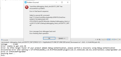

The last couple of months I have been developing on an STM32H757I-EVAL board. Programming and debugging (multi-core) works reasonably well; although sometimes I need to re-power the board.
During the last weeks, we transitioned from the EVAL board to the actual PCB design. Since then I have a lot of issues with debugging of the board.
I use the ST-LINKV2 debugger in combination with STM32CubeIDE 1.18.0.
Most of the times, the ST-LINK GDB server refuses to connect with the following error:
Target connection mode: Under reset
Target connection failed
Target no device found
Error in initializing ST-LINK device.
Reason: No device found on target.
Playing around with the setting shows that the ST-LINK GDB server does not connect when having the '--halt' option specified (to halt both cores). When I omit this flag, the GDB server is able to connect to the target.
I need to re-power the board to get it working again (for a couple of tries, after that it stops again)
Are there any known issues, or do you have any suggestions how I can solve the issue?

MiNe
I am getting this error while I am debugging both cores simultaneously.
