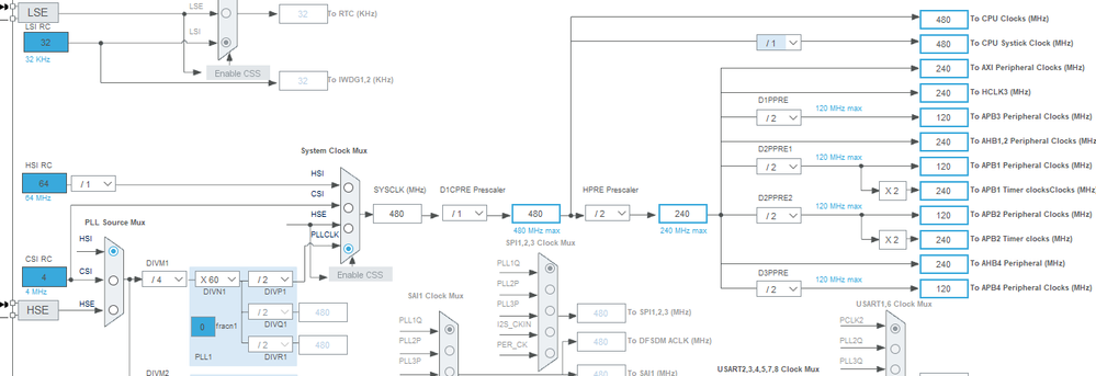

I am trying to set the clock frequency to max of 480 MHz. I tried 120 MHz and there is not problem with that. The block code is very similar for both, so not sure what is going wrong.
I feel the oscillator fails and goes into an error state.
Based on datasheet max speed is 480 MHz and PLLM, N, Q are set based on valid values taken from CubeMX.
I also tried all possible value for "FLASH_ACR_LATENCY_15WS" since this is the only difference between 2 code blocks of 120 and 480.

Kaveh
Thanks! It worked after making bellow modifications.
Here is my findings:
1.Bellow config is a must as you mentioned
  • // Configure the main internal regulator output voltage
  • HAL_PWREx_ConfigSupply(PWR_LDO_SUPPLY);
  • __HAL_PWR_VOLTAGESCALING_CONFIG(PWR_REGULATOR_VOLTAGE_SCALE0);
  • while (!__HAL_PWR_GET_FLAG(PWR_FLAG_VOSRDY)) {}
2.Bellow is also a must when configuring the PLLM, N, Q
  • OSC_Init.PLL.PLLVCOSEL = RCC_PLL1VCOWIDE;
3.It is better to add bellow 2 lines as well to the clock config
  • OSC_Init.PLL.PLLRGE = RCC_PLL1VCIRANGE_3;
  • OSC_Init.PLL.PLLFRACN = 0;
Here is the complete working code. Changes were only made to "SystemClock_Config"

Also note you need some other stuff for 480MHz mode. CubeMX will generate the code for you.

Try using the code generated from CubeMX. You need to do more than just PLL settings to go into 480MHz mode.
Kaveh
