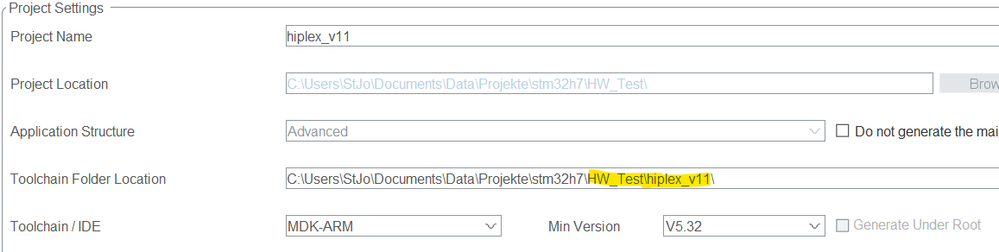

I want to generate code and project files for MDK-ARM and STM32CubeIDE.

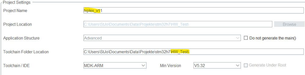

For this I created a new directory and copied the .ioc file into it and opened it it with CubeMx (latest version 6.13).
In the projectmanager/project the following directory structure is shown now:
initial_view.png If I now change the toolchain / IDE e.g. to STM32CubeIDE and back to MDK-ARM, CubeMx adds the project name to the Toolchain Folder Location.

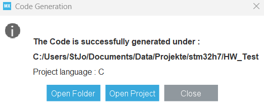

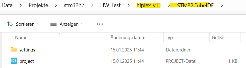

If I now hit the "Generate Code" button, a new directory with the project name is created containing the toolchain directory with the project configuration files.
For example if I select the STM32 IDE toolchain/IDE
the following directory structure is created
directory_struct.png#
I don't want that Toolchain/IDE directory is created inside the <projectname> directory.
I wonder if this is new in 6.13 because a couple of weeks before when I first generated code with 6.12 the following directory structure has been created:
Additionally, after Code Gen the project is automatically imported into CubeIDE but I cannot open the project.
Am I doing something wrong? How can I avoid to create the additional <projectname> subdirectory?

I can reproduce the problem. If I create and save a fresh .ioc project, the .ioc contains these defines
ProjectManager.TargetToolchain=STM32CubeIDE
ProjectManager.ToolChainLocation=
and the directory structure of the generated code is like this
16.01.2025  10:02            23.622 .mxproject
16.01.2025  09:41    <DIR>          Core
16.01.2025  09:41    <DIR>          Drivers
16.01.2025  10:02            27.525 hiplex_v11.ioc
16.01.2025  09:46    <DIR>          STM32CubeIDE

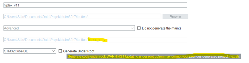

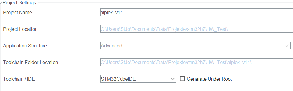

If I now switch to another toolchain/IDE, e.g. MDK-ARM, generate code/project files, then switch back to STM-Toolchain, the projectname is added to the toolpath. If I generate code, a strange warning "Updating under root option may corrupt your previous generated project if exists" appears
and the .ioc looks like this
ProjectManager.ToolChainLocation=hiplex_v11
and now the generated directory structure looks like this

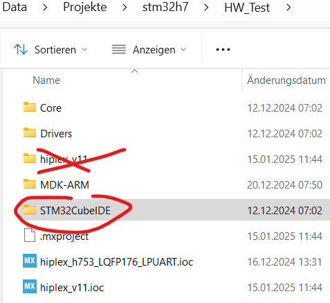

16.01.2025  10:02    <DIR>          hiplex_v11
16.01.2025  09:55    <DIR>          MDK-ARM
Instead of overwriting the "STM32CubeIDE" directory content, an additional directory "hiplex_v11" has been created and an additional "STM32CubeIDE" directory with project files is created inside.
This is confusing and results in IDE/compile problems if the generated code is imported into CubeIDE..
Any idea what this warning is about and how to avoid it?
Is this a bug in CubeMx? If not, what am I doing wrong?
Thanks
EDIT:
The problem does not occure if the project is saved before code generation.
1. Change the toolchain from MDK-ARM to STMCubeIDE (forces "Generate Under Root")
2. Disable "Generate Under Root"
3. SAVE
4. GENERATE CODE
If step 3. is missing, an extra directory is created by mistake.
