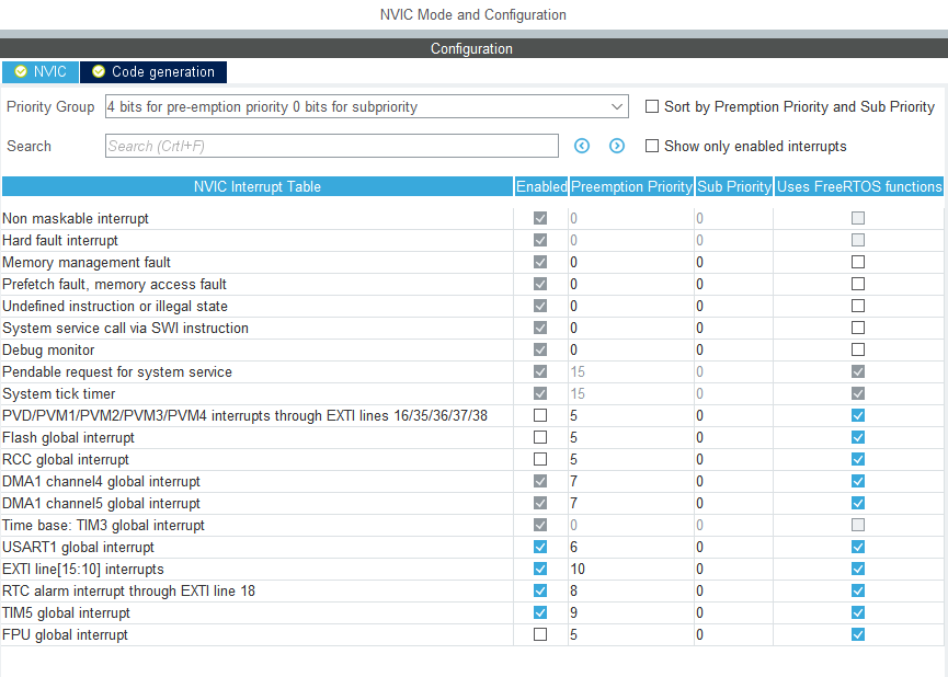

I have made a project with FreeRTOS 10.0.1.
However there is a problem: when I try to call a function with ‘ISR’ suffix from interrupt service routine the macros configASSERT catches mismatch between priority that ISR has and priority that is permissible.
The project was generated by CubeMX v5.1.0. The LIBRARY_LOWEST_INTERRUPT_PRIORITY is set to 15, the configLIBRARY_MAX_SYSCALL_INTERRUPT_PRIORITY is set to 5. Interrupt that is served by the ISR has priority 8. It’s seems that parameters are correct.
I have excluded the checking by configASSERT and the code works properly now, but I am doubting, is it correctly? Why macros gave an error?
Victor

Hi, Jack.
configPRIO_BITS is set 4 (controller is STM32L476RG). As I wrote earlier, ISR has priority 8, configLIBRARY_MAX_SYSCALL_INTERRUPT_PRIORITY  is set to 5. Therefore everything is ok, I think so.
But when I start the program it stops at configASSERT that checks a priority matching.
I saw that place in debugger, it's here (without Cube's comments):
void vPortValidateInterruptPriority( void )
	uint32_t ulCurrentInterrupt;
	uint8_t ucCurrentPriority;
 __asm volatile( "mrs %0, ipsr" : "=r"( ulCurrentInterrupt ) :: "memory" );
	if( ulCurrentInterrupt >= portFIRST_USER_INTERRUPT_NUMBER )
		ucCurrentPriority = pcInterruptPriorityRegisters[ ulCurrentInterrupt ];
		configASSERT(ucCurrentPriority >= ucMaxSysCallPriority );
		configASSERT( ( portAIRCR_REG & portPRIORITY_GROUP_MASK ) <= ulMaxPRIGROUPValue );
The asm code puts to ulCurrentInterrupt value 57. ucCurrentPriority gets from array value 0. The const array pcInterruptPriorityRegisters has almost all values 0, only two members are non-zero and both are not 57th (I don't remember exactly). And first configASSERT stops an execution.
Should array be so long? Or does asm code return wrong value?
I think that error occurs in some place but I don't know where exactly.

If ucCurrentPriority is zero you need to look at where you set the priority for that interrupt vector. The assert is saying you haven't set the priority for the right vector. The priority is not 8, as you assume.
The IPSR vector number, 57, is the index into the VTOR, the table of all interrupt vectors. Look at entry 57. That is not the same as interrupt 57. You need to subtract the ARM core vectors at the beginning, usually 16, to get the interrupt number for an external (i.e. not in core) interrupt. I believe interrupt number 41 (57-16) is I2C2 errors on an 'L476.

Hi, Jack.
I agree that it' look like interrupt priority is not set. It's very strange because when I set a breakpoint to place where HAL_NVIC_SetPriority(RTC_Alarm_IRQn, 8, 0) - in stm32l4xx_hal_msp.c - is called debugger stops.
RTC_Alarm_IRQn is 41 and when we add 16 to it we get 57. All is correct. But when I see pcInterruptPriorityRegisters[57] at breakpoint in vPortValidateInterruptPriority it is zeroed.
Non-zeroed values in that array are:
  • 30th is 122, it suits to DMA1_Channel4_IRQn (14), it was set to priority 7;
  • 31th is 112, it suits to DMA1_Channel5_IRQn (15), it was set to priority 7;
  • 53th is 96 , it suits to USART1_IRQn (37), it was set to priority 6;
  • 56th is 160, it suits to EXTI15_10_IRQn (40), it was set to priority 10;
  • 66th is 144, it suits to TIM5_IRQn (50), it was set to priority 9.
Only 57th element is not set correctly :(
Why doesn't HAL_NVIC_SetPriority(RTC_Alarm_IRQn, 8, 0) work properly?
Victor

0690X000008AHkBQAW.pngI have seen the Cube's NVIC Settings. Settings for RTC and for other interruprts are same. You can see they at this screenshot.

I have found a bug...
The priority of RTC was set from two places =)
One place was in Cube's code, about that I have told earlier. It set priority to value 8.
Second place was in my one code about that I have fogotten at all =) And second place set priority to 0! =)
When we came to configASSERT the 57th element in array had been set to 0 already =)
When I have killed the second priority setting everything works fine.
Thanks for help!
