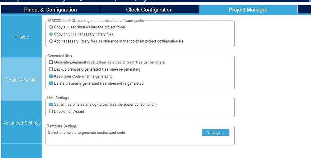

what is the best way to use CubeMX without any deleting functions in CubeIDE?
For code added to the main file, it's clear to use /**User */ comment guidelines but, for functions, should i create another file or module for my functions?

2020-10-16 8:32 AM
You should add the functions in the User Code section:
/* USER CODE BEGIN 0 */
/* USER CODE END 0 */
Ensure that following option is checked : "Keep User Code when re-generating". In this case, the user sections defined by STM32CubeMX are preserved.

Hello @NSemrHomeInit ,
You should set the Backup previously generated files when re-generating option :
Hope this helps you.

One more question please, may be i was not clear in the first post.
if i creat a function in the main.c file, how i could tell cubeMX to no delete it?

2020-10-16 8:46 AM
You might be able to dig the earlier version you lost via windows "previous version" right-click of the file.
I might suggest putting stuff in your own .C file and then #include "mystuff.c" into the auto-generated file. Make sure to back things up all the same, as these tools have a habit of blowing things up. Ideally, put your working build in its own directory, regenerate in a sandbox, and merge to your live one

2024-05-28 7:04 PM
Hello NSemrHomeInit,
Maybe you can set the property of your own source file and folder to read only. Then use generate function of CubeMX dose not delete those files. Just try
