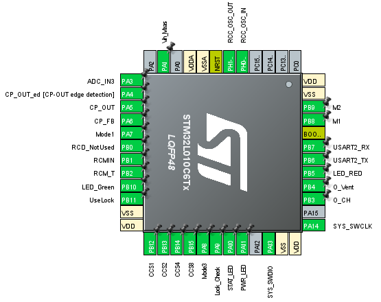

I working with an STM32L010 controller. I have a confusing issue with one of ADC channel.
Here is the configuration:
I using ADC channels 1, 3, 6 and Vrefint.

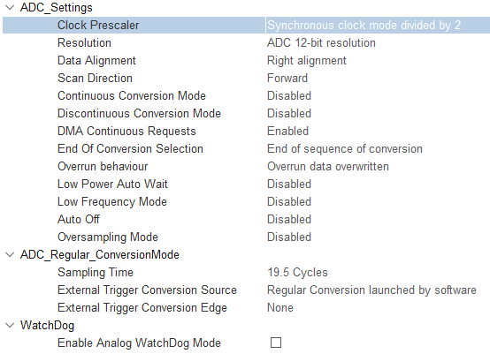

Here is the ADC configuration:

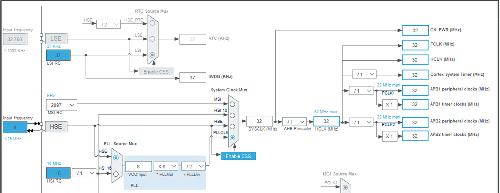

I forgot the clock configuration:
My problem is while the voltage on CH3 increasing from 0 to about 2V the calculated VDD will started to increasing to 3.9V until the CH3 reach 2.4V. In above the VDD falling down to 3.3V. As I see Vrefint value changing. Like it would have a negative characteristic. I using formula from refmanual to convert raw values to mV. On VDD(a) pin I can see about 20mV changes during I increasing voltage on CH3. Could it cause this kind of ADC behavior?

You did not tell us the ADC clock frequency/APB frequency, but I bet 19.5 cycles sampling time violates the min 5us typ. (read recommended ) 10us ADC sampling time when reading the internal reference voltage value given in the datasheet.
