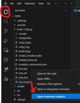

Please be aware that you can invoke build analysis by using the file explorer context menu on any map file
@vincent_grenet  Thanks, I have not noticed this option yet.

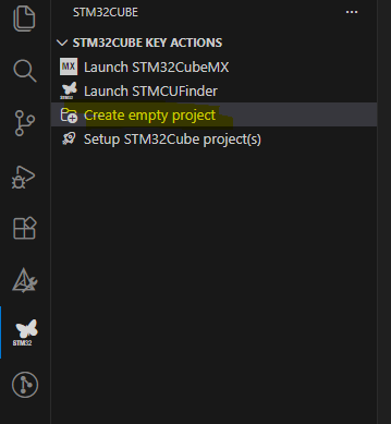

I would also like to point out that this issue does not occur with projects created using the “STM32Cube Project Manager” extension in VSCode.
Attached is an STM32Cube project created via VSCode; you’ll notice that in this case the Build Analyzer has no trouble finding the .map file, even if you rename the project’s root folder. This happens because, unlike projects generated with CubeMX, projects created through VSCode never use CMake’s add_library() function, which is the root cause of this issue (see my first message in this thread).
