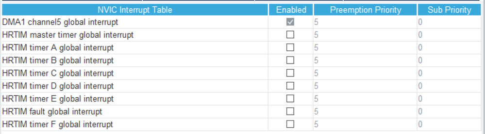

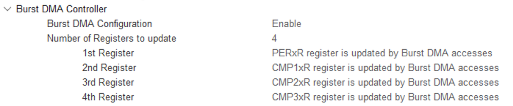

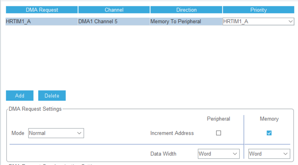

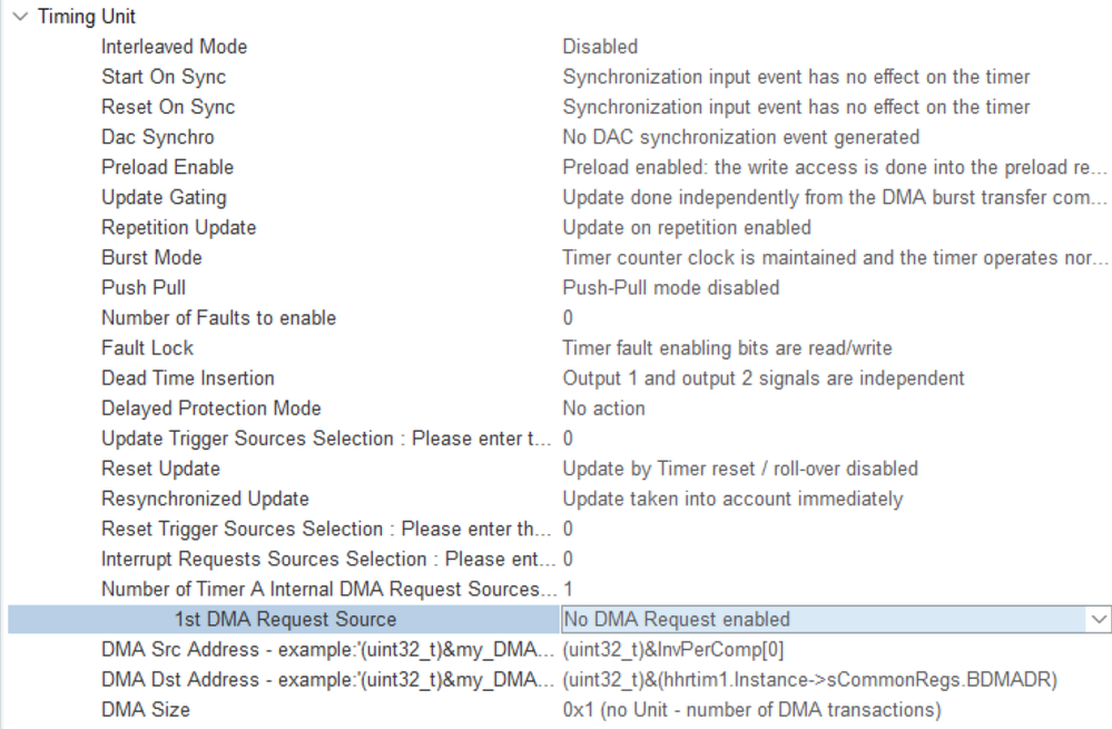

I am trying to figure out to make HRTIM burst DMA working. I want to update timer period, compare1, compare2, and compare 3 registers by using burst DMA. There is not much information about this. There are two postings in the community posted several years ago, and it gave me some idea. But I need to have more information.
  • I used CubeMx to configure and generate code.
  • I want to trigger the burst DMA by software.
  • Assuming that the DMA source buffer data order matches to the order of number of registers to update, for there is no description stated in the reference manual.
  • Nothing happens when I run. It did not stop at burst DMA completion and DMA error callback function when I set breakpoints.
Below screenshots and code are used for the configuration.
0693W00000HqpMyQAJ.pngI am not sure that I need to check on the "Increment Address" or not.
InvPerComp[0] = new_per;    // new period
InvPerComp[1] = cmp1;       // new compare 1
InvPerComp[2] = cmp2;       // new compare 2
InvPerComp[3] = cmp3;       // new compare 3
// Will this update the registers in order?
HAL_HRTIM_BurstDMATransfer(hrtim, timer, (uint32_t)&InvPerComp[0], 4)

  • Can you confirm you use HAL_HRTIM_BurstDMAConfig() to configure HRTIM burst DMA timer x update register (HRTIM_BDTxUPR) ? Please share register values before and after executing this line.
  • Which STM32 are you using ?
  • Can you please share the HAL_HRTIM_MspInit() content ? Have you enable synchronization ?
Best Regards,
Pierre

I am also failing in reproducing the DMA example from https://wiki.st.com/stm32mcu/wiki/Getting_started_with_HRTIM#To_go_further_about_DMA_burst.
HAL_HRTIM_BurstDMAConfig() is mentioned in the text, but not present in the code example. Did you miss to put it into the example?
Minor issue: I find it weird to edit HAL_HRTIM_MspInit() to change DMA_MEMORY_TO_PERIPH to DMA_MEMORY_TO_MEMORY as this gets overwritten by the next code generation.
Would it be safe to put this in the user section below:
    /* USER CODE BEGIN HRTIM1_MspInit 1 */
    hdma_hrtim1_a.Init.Direction = DMA_MEMORY_TO_MEMORY;
    if (HAL_DMA_Init(&hdma_hrtim1_a) != HAL_OK)
      Error_Handler();
    /* USER CODE END HRTIM1_MspInit 1 */
This would result calling HAL_DMA_Init() twice. Is this OK?

What I would like to achieve in the end is a running HRTIM1 where the MPER register gets updated with every period. I assumed this can be achieved with burst DMA.
The example from https://wiki.st.com/stm32mcu/wiki/Getting_started_with_HRTIM#To_go_further_about_DMA_burst is the only one, I could find.

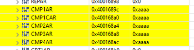

In order to learn more about burst DMA, I started experimenting. First, I wanted to update multiple registers.
I am writing to the four CMP registers and preset them with different values to visualize it better:
static uint32_t reg_update[] = {
		0xaaaa,
		0xbbbb,
		0xcccc,
		0xdddd,
static inline void BurstDMA_Test(void)
	HAL_StatusTypeDef ret;
	HRTIM1->sTimerxRegs[HRTIM_TIMERINDEX_TIMER_A].CMP1xR = 0x11;
	HRTIM1->sTimerxRegs[HRTIM_TIMERINDEX_TIMER_A].CMP2xR = 0x22;
	HRTIM1->sTimerxRegs[HRTIM_TIMERINDEX_TIMER_A].CMP3xR = 0x33;
	HRTIM1->sTimerxRegs[HRTIM_TIMERINDEX_TIMER_A].CMP4xR = 0x44;
	ret = HAL_HRTIM_BurstDMATransfer(
			&hhrtim1, HRTIM_TIMERINDEX_TIMER_A, (uint32_t)reg_update, 4);
	if (ret != HAL_OK)
	   Error_Handler();
 But that just gave me:
So, the first value is copied into all the configure registers.

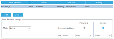

OK, so maybe I have to set the "Increment Address" for the DMA configuration:
But this results in only one register being updated:
I am puzzled!
So, my first piece in understanding would be: How to update multiple registers from a single buffer.
