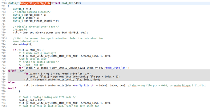

Hi, I have a project to finish where I have to use a bma456, which is a step counter sensor, on stm32CubeIde. But I can't seem to be able to do it, by running my own code or by using the code given on the git, I always seem to be stuck on the burst and the use of the initialisation file. The site is https://wiki.seeedstudio.com/Grove-Step_Counter-BMA456/
if anyone has already did a project on this type of sensor please help me, the deadline is coming at a rapid pace.
I have all the basic functions on STM32CubeIDE but everytime I implement something to work on this sensor, I end up stuck.
I just need to retrieve data, that's all
Please help me

    So I have the code of the github, except that I replace the class by struct and the arduino code used to send data by a Hal_I2c_Write.

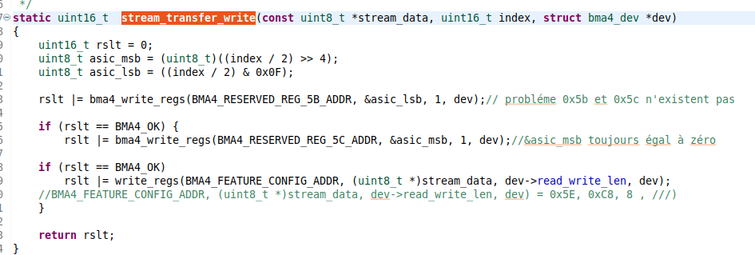

    The problem that I stumble upon is I need to send an enormous amount of data ~ 1700 on a register 0x5E, 0X5C and 0X5B. The problem is that I'm stuck in the "for" that is sending the data. I never get to the line 793

    Link to the GitHub repo that you're talking about, show your code additions..
    This One?
    https://github.com/Seeed-Studio/Seeed_BMA456/blob/master/arduino_bma456.cpp
    How does it handle failure? ie not seeing NACK for slave access. You have to fail 1700 times? Or fail once to know it's not working?
    ST expects the Slave address to be in the top 7-bits, usually requiring (slaveaddr << 1) vs Arduino

    In the "bma4_defs
    you have to set
    /**\name I2C slave address */
    #define	BMA4_I2C_ADDR_PRIMARY	UINT8_C(0x18)
    #define	BMA4_I2C_ADDR_SECONDARY	UINT8_C(0x19)
    #define BMA4_I2C_BMM150_ADDR UINT8_C(0x10)
    to
    #define	BMA4_I2C_ADDR_PRIMARY	UINT8_C(0x30)
    #define	BMA4_I2C_ADDR_SECONDARY	UINT8_C(0x32)
    #define BMA4_I2C_BMM150_ADDR UINT8_C(0x20)
    Note arduino != STM HAL
