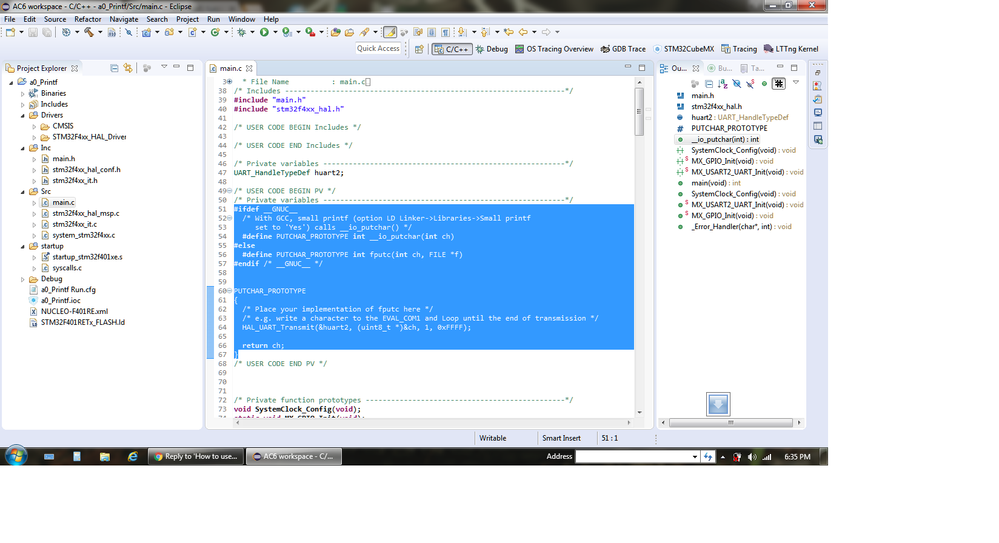

‎2017-10-18 4:05 AM
PLEASE ALLOW ME TO ADD DETAILS OF WHAT I'VE DONE, TESTED ON NUCLEO F401RET
1. Using CUBEMX, I configures USART 2 as my serial communication (set as Asynchronous) and let it (cubemx) generate all initilial files and folders
CUBEMX USART2 SETUP:
- Asynchronous
-Parameter Setting by Default, except Baud Rate is 115200
-NVIC Setting, uncheck the UART global interrupt
-Did not touch the rest
- Finally, hit the Generate Code Icon !!
2. Opening the project with AC6 Workbench we should see something like this
3. NOW LET'S DO THE ADDITIONAL CODES AND SOME STEPS
Step 1 Let's add the following two function in our main.c - you can place them above the main() function
in my case i paste it on /* USER CODE BEGIN PV */ see highlighted
#ifdef __GNUC__
#define PUTCHAR_PROTOTYPE int __io_putchar(int ch)#else #define PUTCHAR_PROTOTYPE int fputc(int ch, FILE *f)#endif /* __GNUC__ */PUTCHAR_PROTOTYPE
{ HAL_UART_Transmit(&huart2, (uint8_t *)&ch, 1, 0xFFFF);return ch;
}see pic below
Step 2 : Modify the linker flag in the project properties.
2.1 Go to Menu: Project\Properties\
2.2 Expand C\C++ Build on left pane, select Settings
2.3 On middel expand MCU GCC Linker drop down menu, and select Miscellaneous
2.4 Now on the rightside you can see the the ''Linker Flag'' text box.
2.5 Replace/update the text to
-specs=nosys.specs -specs=nano.specs -u _printf_float
Hit Ok
Step 3: Locate the file ''
syscalls.c
'' and place it on startup folder i.e. together withstartup_stm32f401xe.s
It should appear in the ''project explorer'' under ''startup'' folder
I found syscall.c in the repository of example folder of CubeMX . i.e. C:\Users\My\STM32Cube\Repository\STM32Cube_FW_F4_V1.16.0
STEP 4: I did check on STM32F401RETx_FLASH.ld file (on file exporer, its the file on the last - see picture) as suggest in the comment above and it is
0x20018000 by default so i leave it as is.
/* Highest address of the user mode stack */
_estack = 0x20018000; /* end of RAM */FINAL STEP. Finally I tried and run inside loop
printf
(''%f\t %i\n''
, 0.1250f, 12345); It woks.Hope will be useful for future user. I wish printf() would be a straightforward feature of the IDE so we don't have to work around.
If there is better approach, please share.
I Thank you for all the inputs mentioned in this forum.
