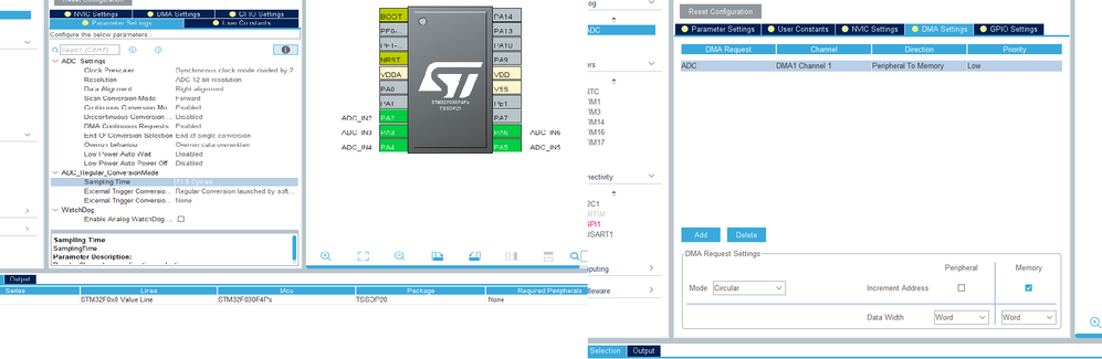

Okay, i have working code. I just did what says the example(before i wasn't about examples in documentatnion).
If somebody will also problem with it, heres solution.
Cube conf:
And code:
/* USER CODE BEGIN PV */
int data[5];
/* USER CODE END PV */
 /* USER CODE BEGIN 2 */
  if(HAL_ADCEx_Calibration_Start(&hadc) != HAL_OK){
	  Error_Handler();
  if(HAL_ADC_Start_DMA(&hadc, data, 5) != HAL_OK){
	  Error_Handler();
  /* USER CODE END 2 */
 /* USER CODE BEGIN WHILE */
  while (1)
	  HAL_Delay(1);//for debugger stopping only
    /* USER CODE END WHILE */
Thanks all for help!

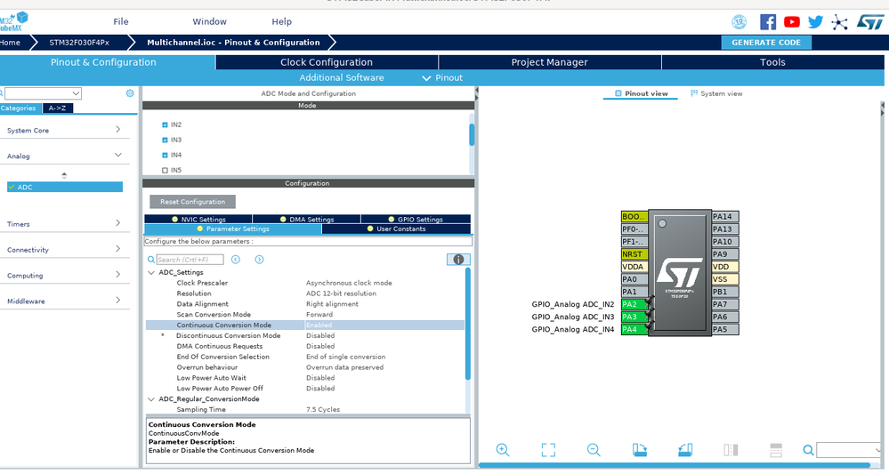

My currently conf is:
My code:
int reading[];
/* USER CODE BEGIN PFP */
void HAL_ADC_ConvCpltCallback(ADC_HandleTypeDef* hadc){
	int i;
	for(i = 0; i<3; i++){
		reading[i] = HAL_ADC_GetValue(&hadc);
/* USER CODE END PFP */
	HAL_ADC_Start_IT(&hadc);
Debbugger says, thats not entering into a ConvCplt callback function.
And if i stop manually, of course reading 0, 1, 2 are empty.
ADC interrupt is also Set in NVIC section.

OK, i cant do it, it's too difficult. Lets try the Polling mode. Now my conf looks like this:
And my code:
uint16_t reading[3];
	while (1) {
		HAL_ADC_Start(&hadc);
		HAL_ADC_PollForConversion(&hadc, 200);
		reading[0] = HAL_ADC_GetValue(&hadc);
		reading[1] = HAL_ADC_GetValue(&hadc);
		reading[2] = HAL_ADC_GetValue(&hadc);
		HAL_ADC_Stop(&hadc);
Now, readings from 3 channels are completely random. I set three pots, first(CH2) have grond on output, second(CH3) have some from 1 to 3V, and the third(CH4) have Vcc potential(3.3V).
If i stop debugger at HAL_ADC_Stop(&hadc), readings looks like completely random, eg:
0: 1720
1: 1720
2: 4030
always first 2 readings are from CH3, and 3rd reading from CH4.
Wheres CH2? And why CH3 are doubled?
Theres any way to SIMPLE read more channels than one?
raptorhal2
Lead
Yes. As clive pointed out, set up DMA ADC conversion to place the 3 conversions in a buffer. Poll the DMA transfer count, and when it decrements to zero, read the buffer values. Or, you can set up a DMA interrupt to trigger when the DMA count is zero.
There is a DMA ADC example in the library package. Usually the example converts one ADC channel, you will have to modify it to convert 3 channels.
Regards, Hal

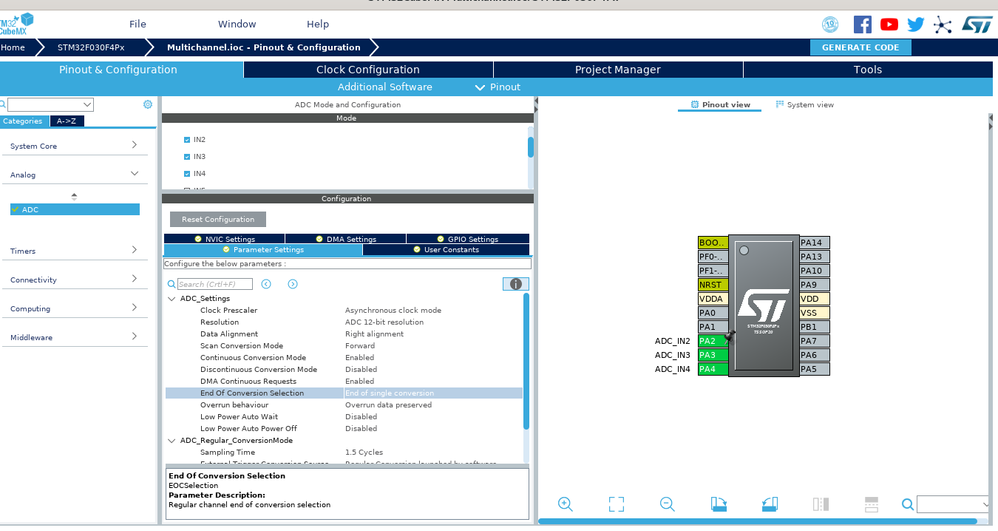

BBart.16
Cube conf:
And code:
int data[5];
	  Error_Handler();
	  Error_Handler();
  while (1)
