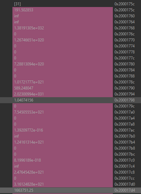

I am trying to use DTCMRAM on my stm32h743zi micro.
When i use an array located from 0x20001760 to 0x200017d4 there are some positions that do not update, it stays in 0 or "inf" value, but when i use other array located in different location, it works perfectly.
My question is..., Is there any reserved directions in this memory that are not allowed to use? If yes, how can i know which positions i can not use?

Hi @TDK2 . I show you in the next image, there are a few values in 0 and then in "inf" using these directions.
But if i use other array with other directions, everything works perfectly. I am lost in this problem.
Thank you so much

The problem is that you want to use uninitialized memory where you have not written any data. The C library zero-initializes only the "bss" memory defined in your program. If other memory areas should be zero-initialized, do it yourself.

I was looking for the issue and... I was using a variable that was overwriting some position of the array that I sent here..., indeed, the addresses can be fully used.
